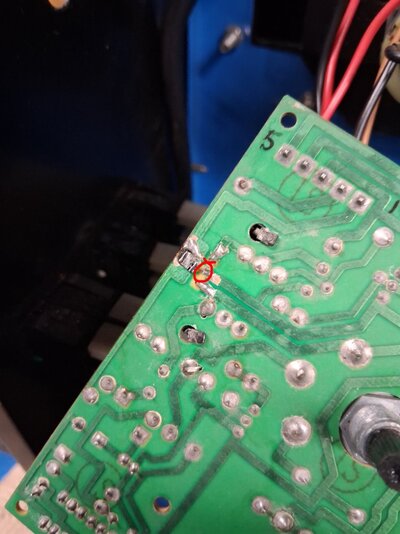

My 135 was working fine until it stopped feeding, initially I thought it was the gun. Stripped and cleaned contact spring and block seemed to resolve. On the next welding run it died again, initially I thought it might have been duty cycle but after leaving there was still no joy.
Cover off and PCB inspection, all tracks look...
The 30v AC output of the small transformer on the board is half-wave-rectified by a diode and fed to the operating coil of the relay when the torch switch is closed at Pins 1 and 5. You could jumper across those pins to test, and trace the tracks from the transformer secondary to find the diode.
On the "EN" models the torch has two thin wires connected to the switch. [ Gas-only models have only one, and "borrow" the main DC power cable in the torch sleeve as the second switch conductor.]
The power transistor and the rest of the speed control circuit for the wirefeed motor is separate to the relay power-up circuit.
