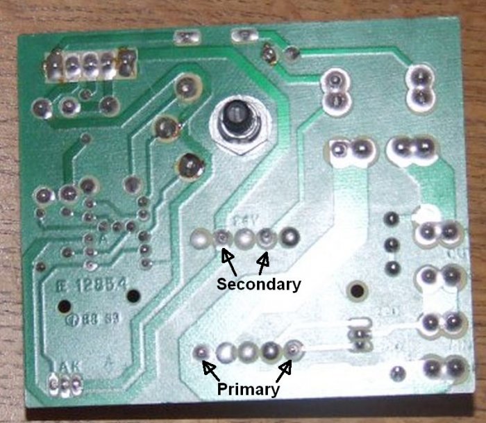

i have a clarke 100e its about 28 years old its allways regularly maintained but the wire will no longer feed
so i have had a quick look through all of the components inside the case and if i operate the blue relay (they seem to be orange on the newer ones from what i can gather) by hand the wire will feed
great start, so now after a few shocks i am s**t scared of doin more as my knowledge with wires is not the best i have a multimeter but dont know how to use it :/
at a guess one of the components on the board has failed but i cant figure out which one
has anyone else come across this problem as i have had a good search and only seem to find things like the realy will not work by hand
thanks in advance
