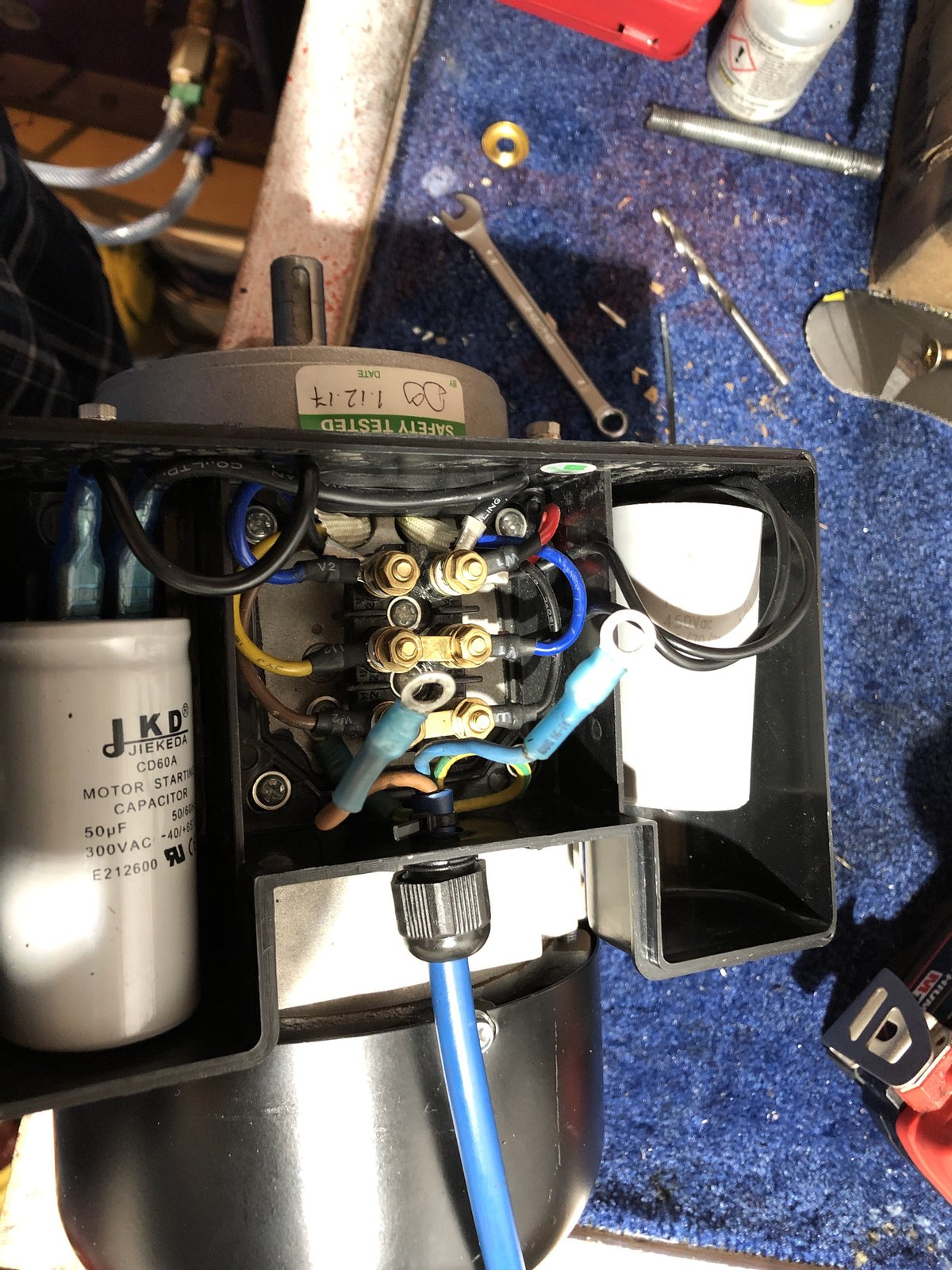

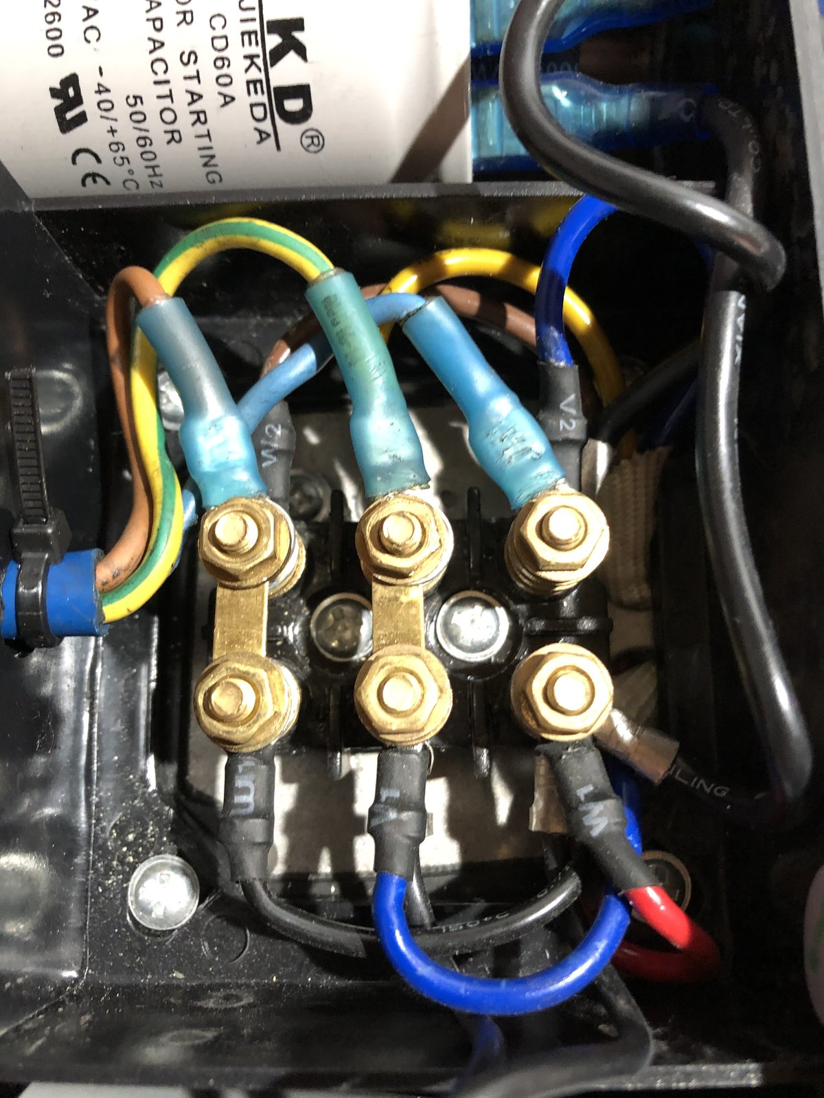

this is the new motor I got from machine mart can you tell me if I’ve wired it up properly and does this sound right
No diagram just showing you how to reverse it do you know how to wire itNo, it’s not right, the earth should go to the motor case not a winding, wha there a diagram with it?
That's just how I was told to do it when I was in the shopNo, it’s not right, the earth should go to the motor case not a winding, wha there a diagram with it?
I'll go take some picturesAs Spark Plug said, definitely not right. Green/Yellow is earth for a start.

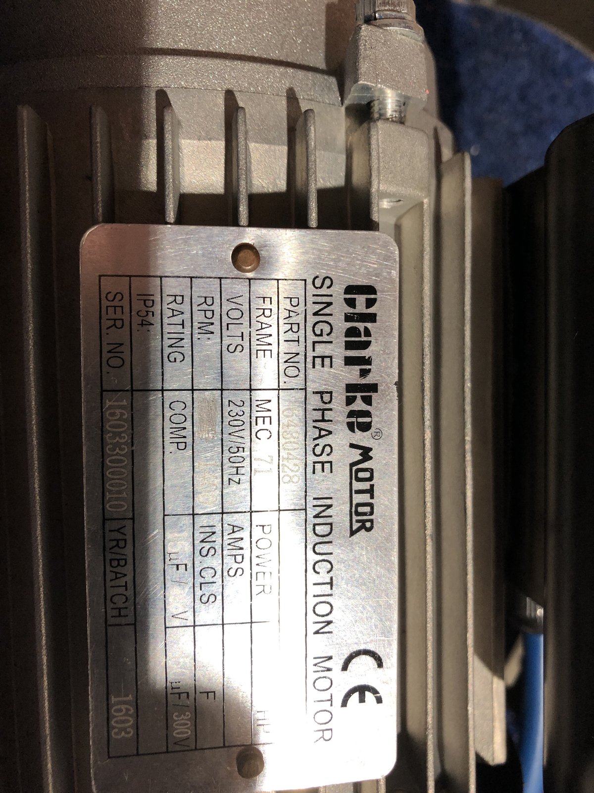

What model number is it?
This is it without any wires connectedAs Spark Plug said, definitely not right. Green/Yellow is earth for a start.
I was told it was a single phaseThat's a three phase motor. Why the capacitor? I thought you wre going single phase.
Is says it’s 230vThat's a three phase motor. Why the capacitor? I thought you wre going single phase.

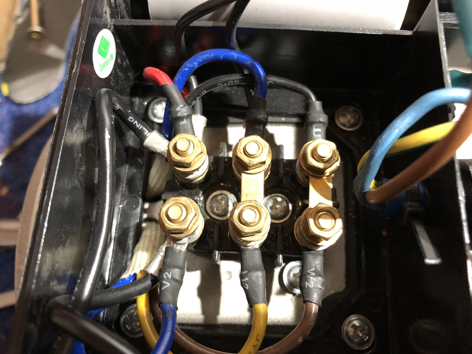

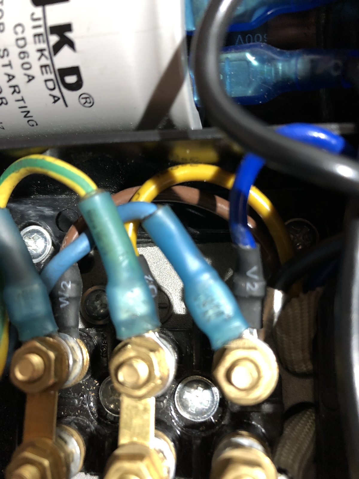

Thanks for that but the wires are different coolersHeres how my clarke is wired up, got it like this from a forum member and works fine...
try your live and neutral from the power cable on the first 2 connectors, as in the closest to the cable entry gland *edit make sure your earths on the body of the motor as wellHow can I wire it up
