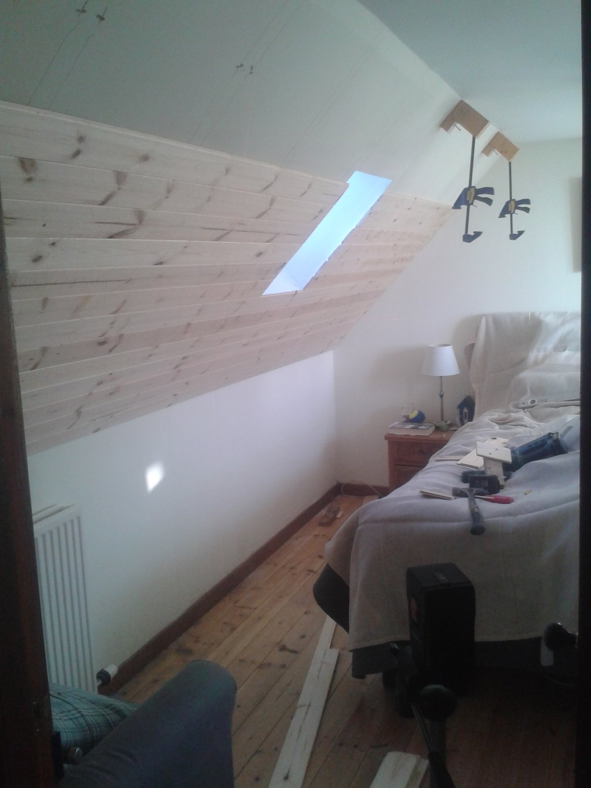

im doing burdekins cladding in wood ceiling and walls wanted some sort of clamp or vice to clamp wood up and push them together
spotted this on you tube
so made some quick ones up using some 6" joists and nogged out so i could screw into the joists
simple idea for the above video
grind the lug off turn it around and youve got a clamp
