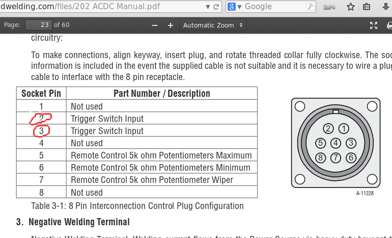

If you don't to cut the connector on wp26 and continue to not use the foot pedal you will need (I don't know if there is a version of this torch with an integrated button if there is so skip the button part that I talk next):
-An 8 pin amphenol plug ebay has quite a few.
-A button zip tied to the torch body (if the torch you buy doesn't have one integrated if it has skip this)
-Wiring the 2 wires from the button to the pins 2 and 3 of the 8 pin connector(this one I just checked on TA manual).
And it's done, as simple as that :-)View attachment 58067
