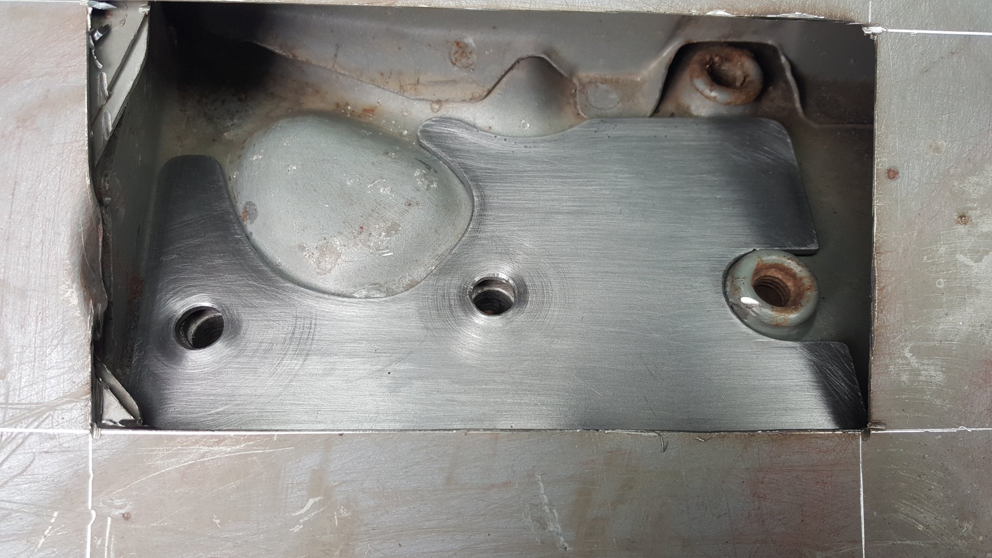

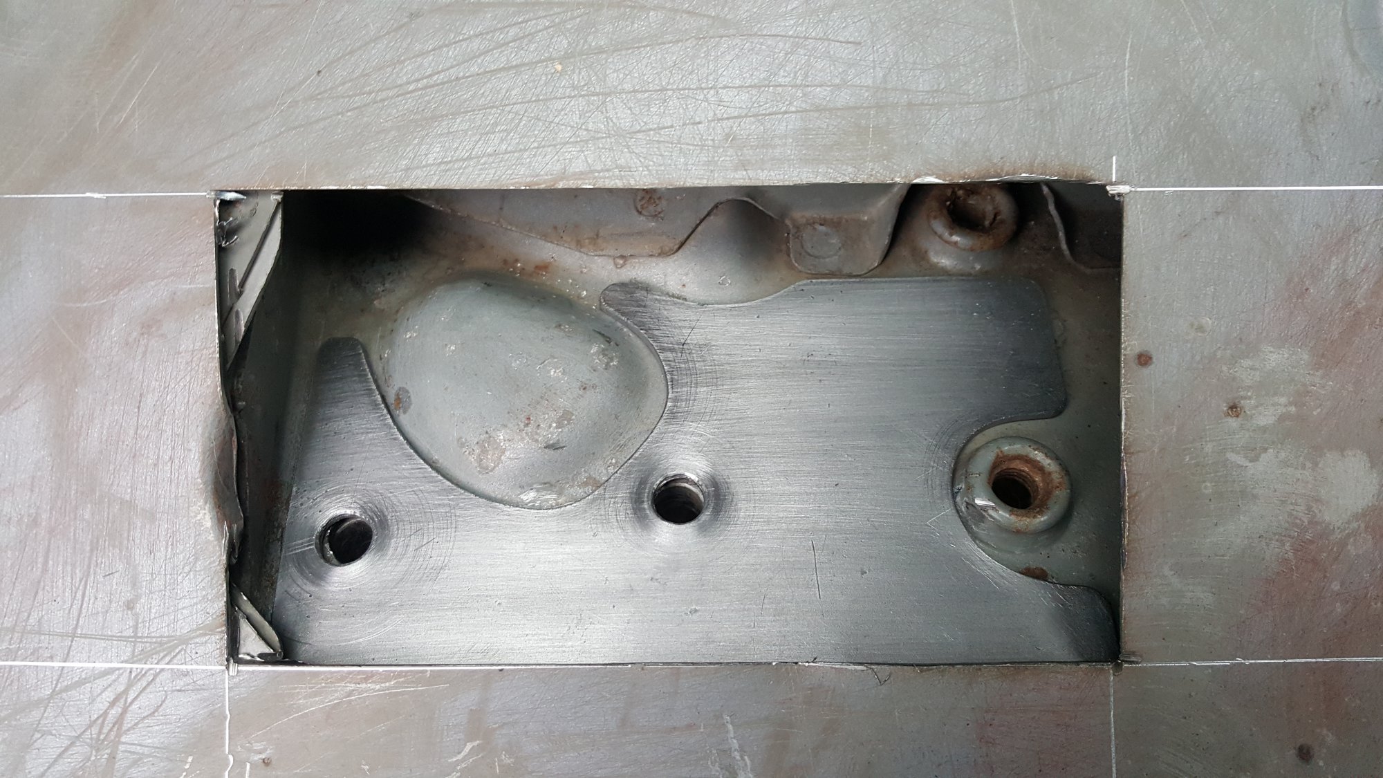

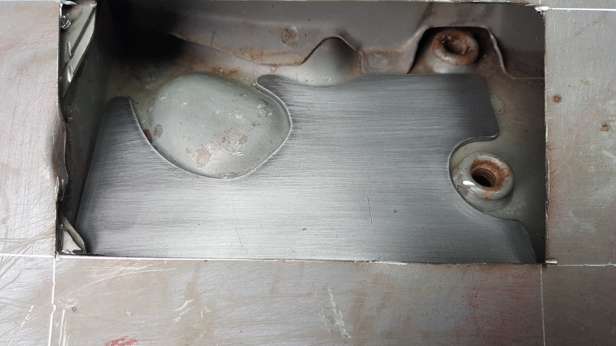

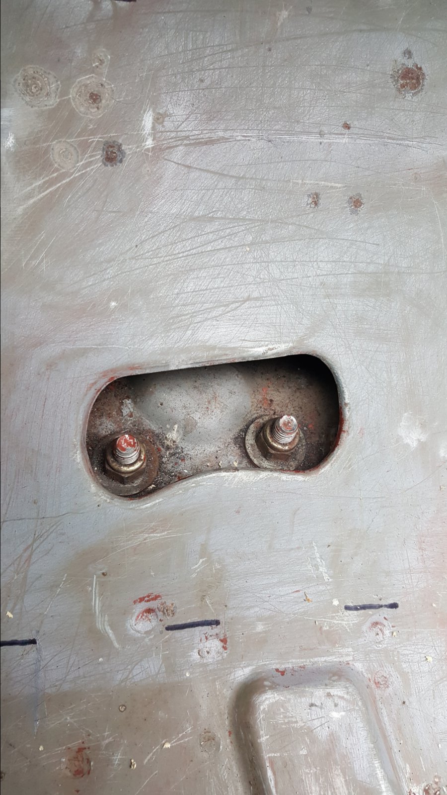

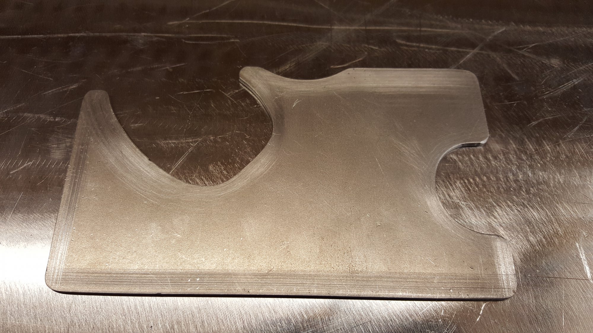

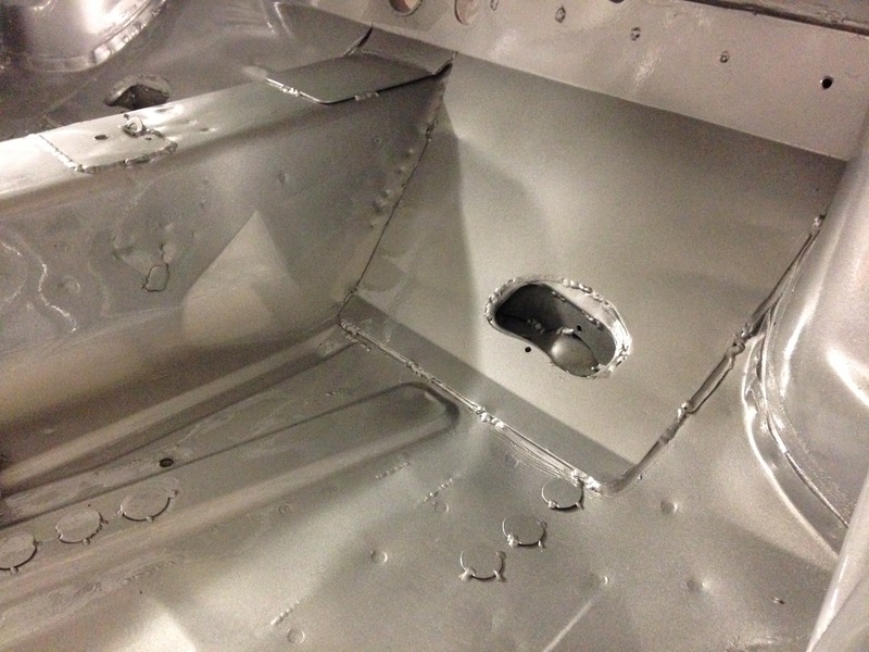

It's reinforces the floor pan area where the anti roll bar mounts to. The satchell front suspension uses a compression strut instead of the ant roll bar. There will be steel tubes that are welded to the plate and they will be where the bolts sit. Two tubes each side. Similar to the picture.What is the bulkhead plate for?
