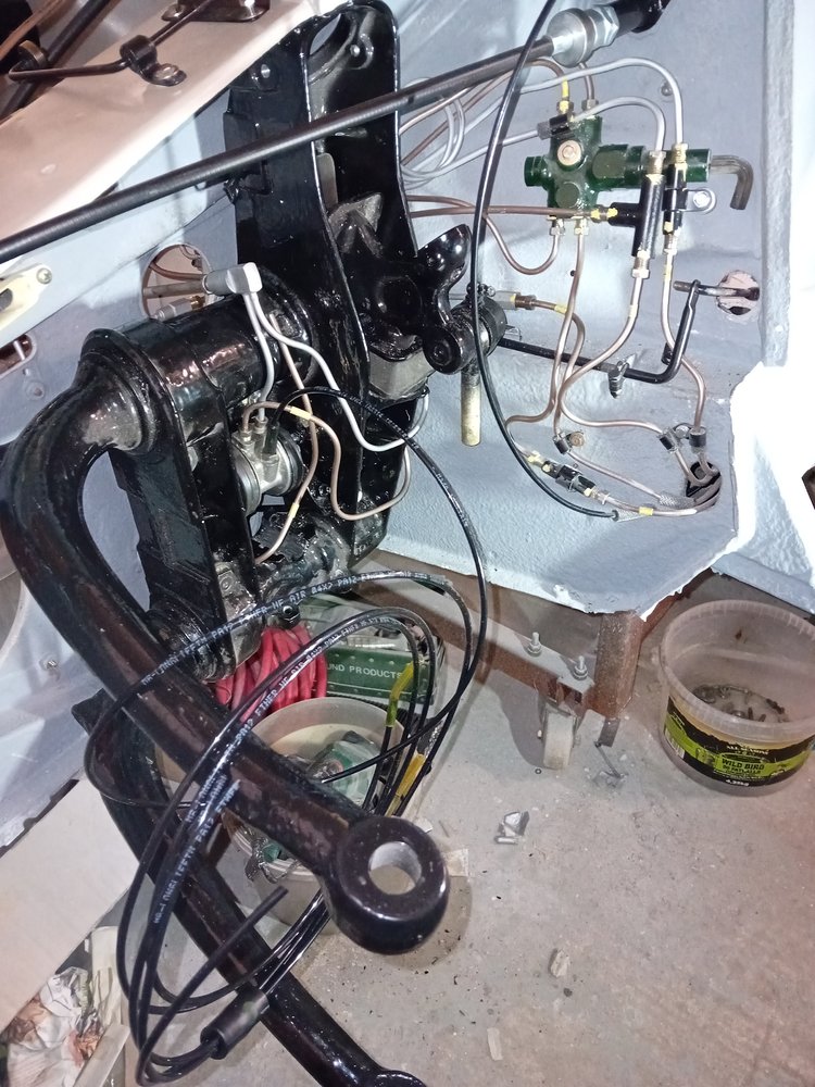

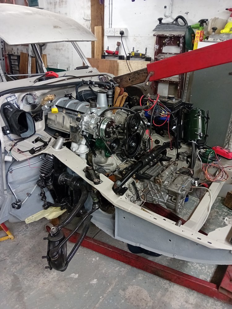

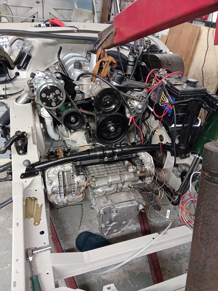

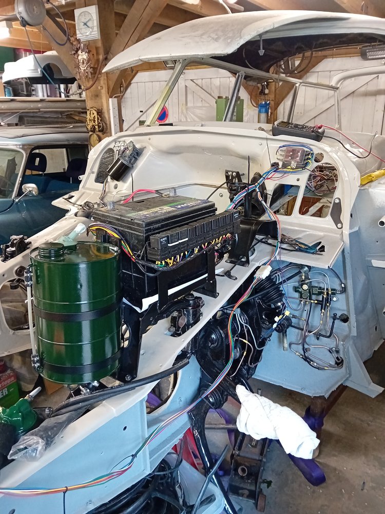

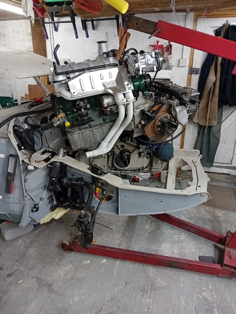

You coming over for this?I'd already re-plumbed the hydraulics and re-wired (own loom) the car before fitting the engine.
Connecting all the other control cables and linkages etc is like rewiring a plug through a blackthorn hedge. You can see it but you just can't get your hands on it.
Adjusting the handbrake calipers needs a two inch long 14mm open ended spanner reduced in thickness by half.
I really need the help of a four year old child with a vice like grip.
Thats how I set up my MTB disc brakes.Unlike most cars, the brake calipers are left loose until it can be started and the brake pedal pushed down. That centralises the calipers and they can be tightened.

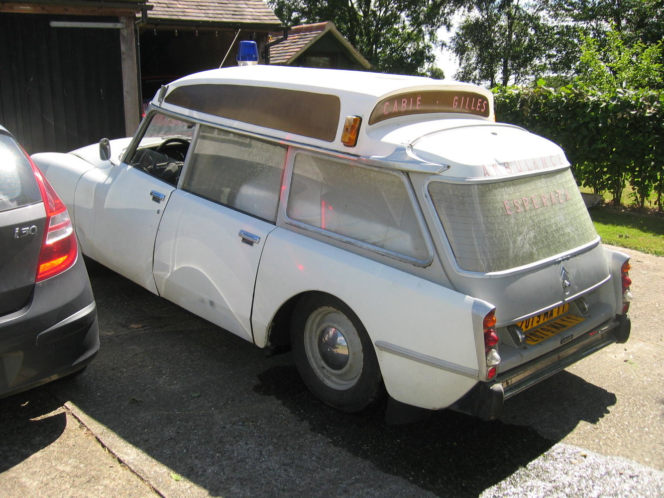

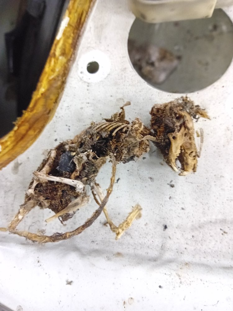

When I worked in the food industry we had to have a vets office. We only had sliced ham on site, I have no idea what he was going to do for it.In the door, beyond resuscitation.View attachment 528580

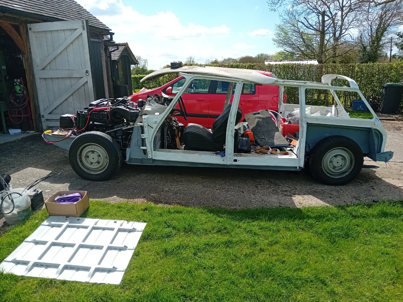

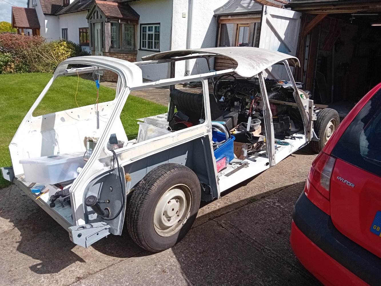

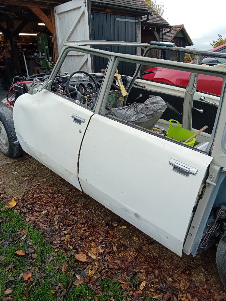

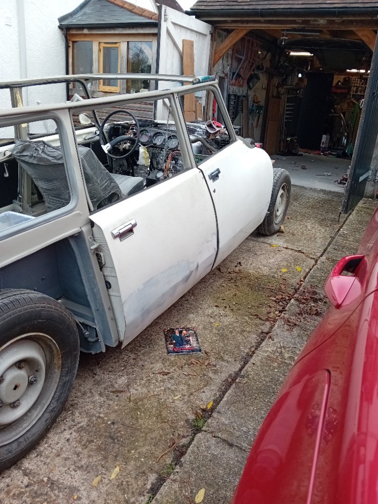

Happy Anniversary 1 year old project today![]()
