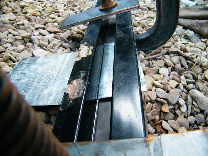

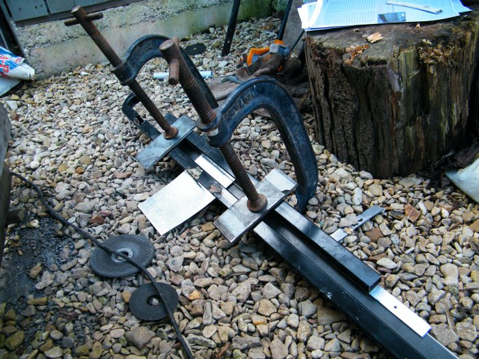

. I'm assuming if I just wire brush off the coating around wherever I want to weld, it'll be all right?
An for anybody that moans about "the youth of today" this young chap has no fear and is getting stuck in where many 6k rsetorations fear to tread

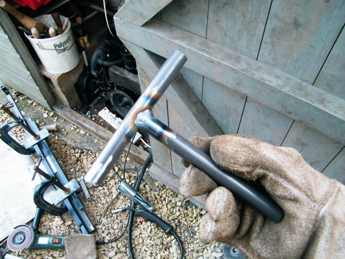

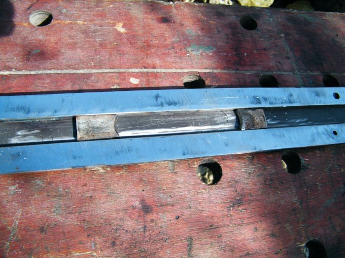

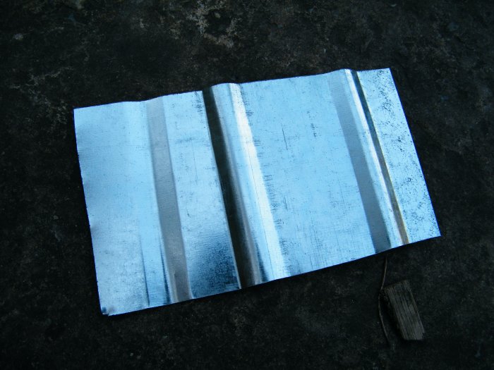

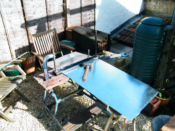

paul33 said:You are on the right lines with the tool George, you would be better with solid bar rather than tube tho because you can round the end, if you need anything turned up don't be afraid to ask![]()

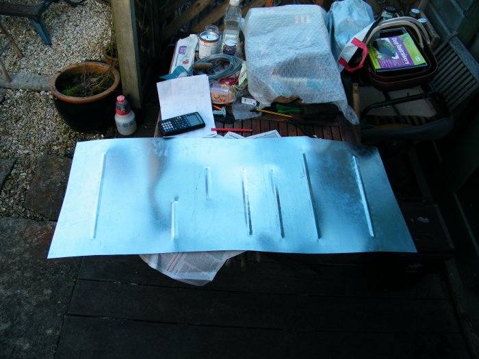

I'd have liked to try and prevent it in the first place, now I know, but I think I'll be able to deal with it, and there's a parcel shelf behind it and a few other bits that should hold it all nicely in shape. Finger crossed!
