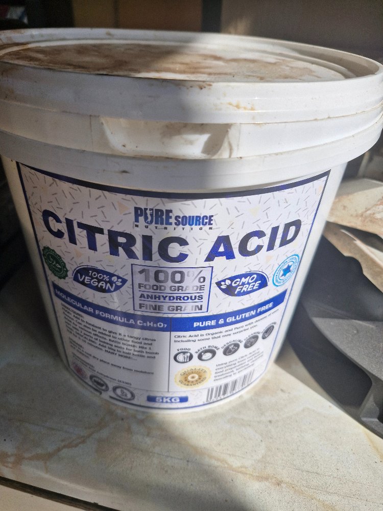

I am totally new to zinc plating. It was VERY hard to find a kit who would post to NI. Eventually this more expensive kit was posted and should arrive monday:
I see on you tube people use Muriatic acid to clean their bolts at 10% or so dilution "readily available from your local hardware store". (Yanks!)
I think if I go asking for pure acid locally ill get arrested.
Is that a thing or can I use warm Citric acid for the prep stage?
Finally, I presume I need to buy a 5 gallon drum of distilled water for this kit as there is no real alternative is there?

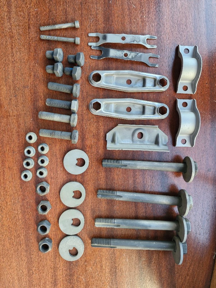

Its items like this I want to yellow zinc plate
These were blasted and left overnight in citric. I will also wire wheel buff them to shine before plating.
