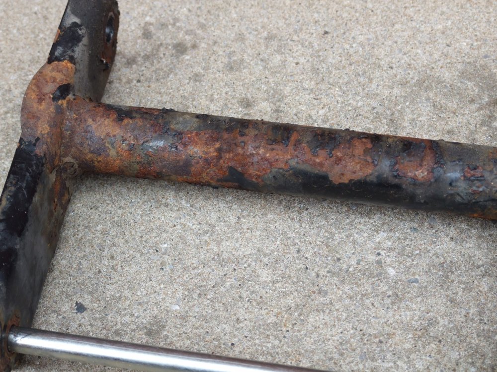

Right. A friend asked my OH if we could weld a repair to his car part. It was rusty so I tried it out with the citric acid mix. I used very hot water, soaked a couple of days. Cleaned it up a bit, then soaked again in a fresh solution. This was before:

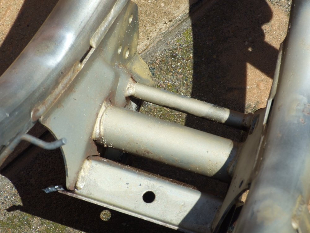

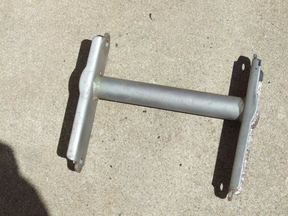

This was after, though it has been cleaned up with a sanding bit on a Dremmel:
