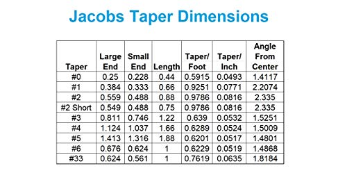

I need to buy a chuck for this -
(the z3 one)
The device is a pillar drill / tapping machine.
The manual (attached) says "Spindle bore taper (Morse): No.3"
Can i make a mistake and buy the wrong thing with that information?
(i know next to nothing about this specific area)
It seems that i can (have to) buy the chuck and the arbour separately, and join them?
I've had my existing pillar drill for years and years... When i first started with it, the chuck / arbour would frequently drop out. Its so long ago that i cant recall how this was resolved. I have in mind talc or something, but its all a bit hazy.
Anyway, i want, if possible, to avoid that kind of thing this time around!
