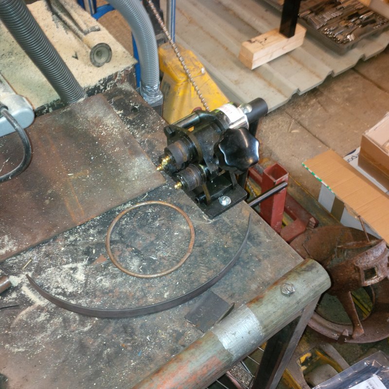

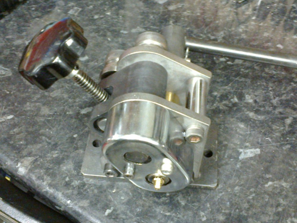

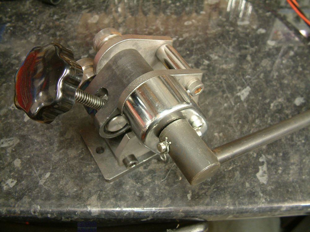

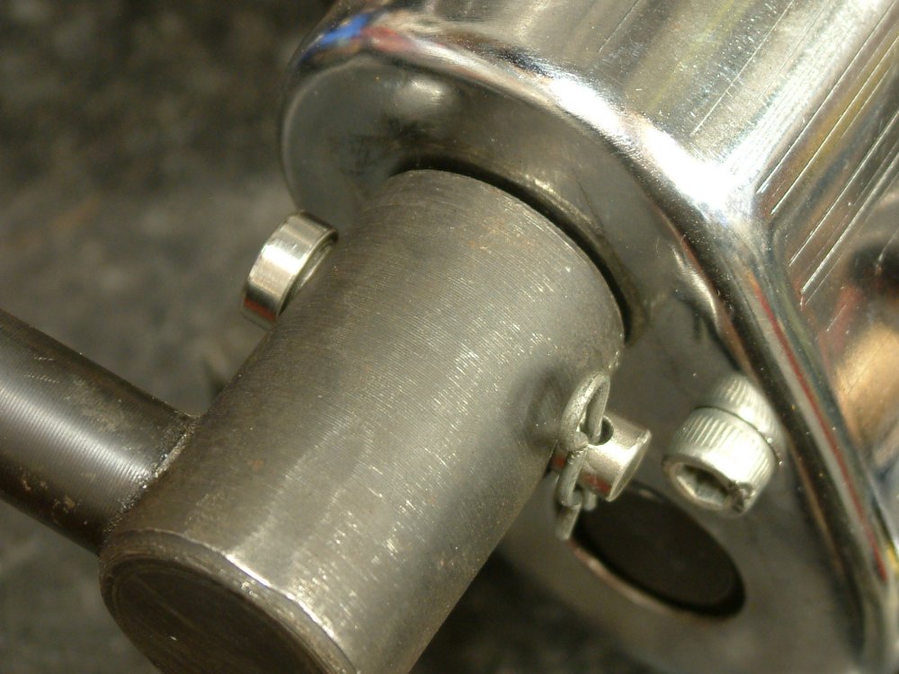

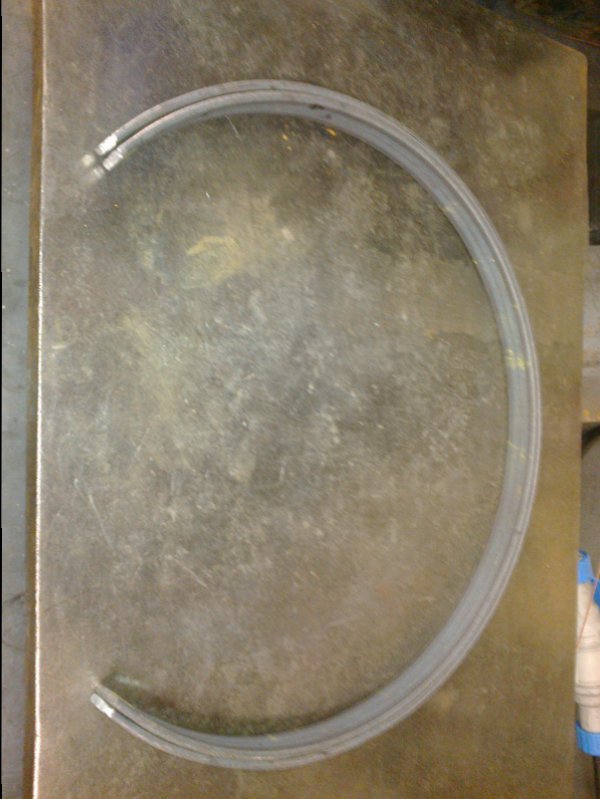

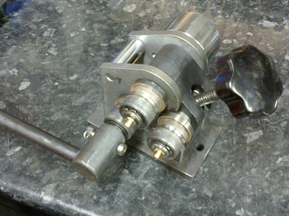

Fettled a couple of other bits today, made a pin for the handle from an old stainless bolt with an R clip and decided it was time to grease it up and give it a whirl. Both my grease guns were empty.......

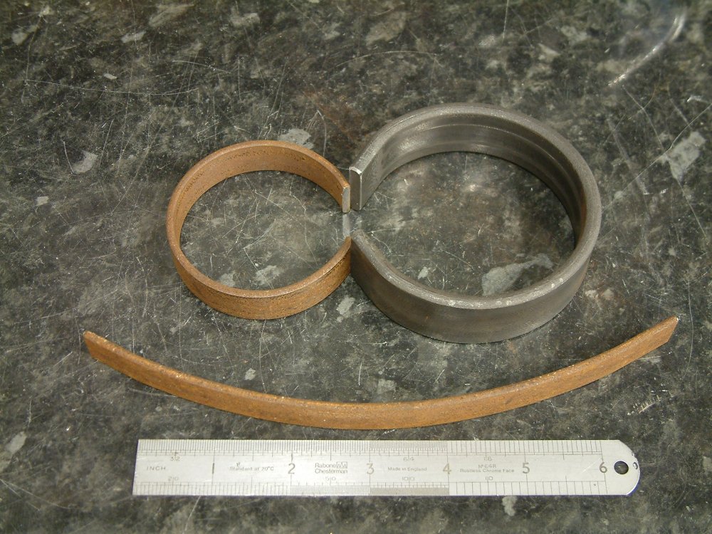

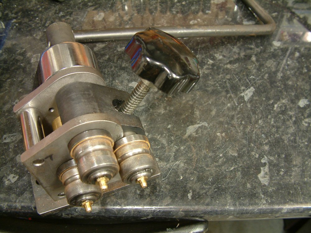

I don't think I will bother modifying it to take thicker material as it really isn't up to it. A couple of adjustable guides would be a nice addition to keep the strip against the back of the rollers and allow you to feed the strip quicker then I suppose a reversible motor would be the next addition.
The Bead Roller sulking in disgrace gathering dust under the bench is the next POS on my hitlist.
Tried 6mm x 25mm and it really didn't like it, the 3mm was too easy!
Pin for the handle made from an old bolt.

That's a fine looking machine, where did you get that?
Seeing yours bolted to the bench has given me an idea, if the keyways are the same length I'll try swapping the drive shaft round so the handle is at the front on the bottom roller. Might make it easier to operate.
