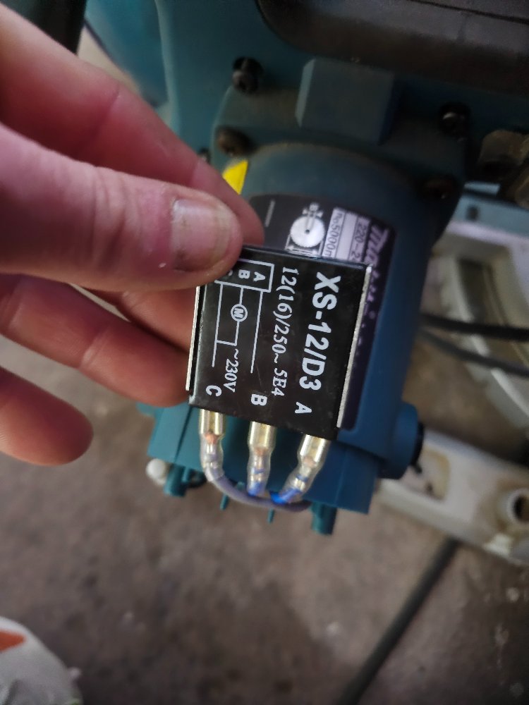

Ive got a chop saw makita ls0815fl
Not working looking at for a mate
Ive checked all the connections/wires inside the unit the switxh when pulled shows power going through and power gets to the soft start an xs 12/d3
When the switch is pressed the gray wire im getting 240v(c) the right blue wire is a also gets 240 the middle one (b) gets nothing
Ive checked with a meter between a to c and I get a high reading in the 200k setting on my meter about 1560
Between a-b and c-a nothing in any setting in ohms or diode setting
Im I right just for a quick test remove the soft start all together as all wires are live i can just wire the 3 Iives together to confirm its this is the problem is my thinking ? (Though I know its not good for the mechine but as a test to see if its this is at fault ? If then buy another and fit it there about 30 quid so not loads money but don't want to spend to find its the winnings that are duff (also the winding are not easy to get at to measure them to rule them out)
The brushes are a bit short but do have a fair amount of meat on them so again are ok for testing and if once working will replace them as im sure for less than a 10er it would be worth it
