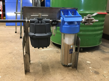

This is my set up for the plasma table. I also have a water separator on the compressor. The blue item is a 10 bar water filter filled with Premium Grade 3A Molecular Sieve Dessicant (the central filter element prevents dessicant from leaving the filter), then a standard water trap followed by a Filter-EX element. The stop valve on the inlet prevents backflow of dessicant in the event of an upstream air line disconnection.
