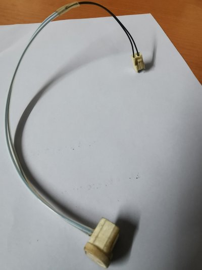

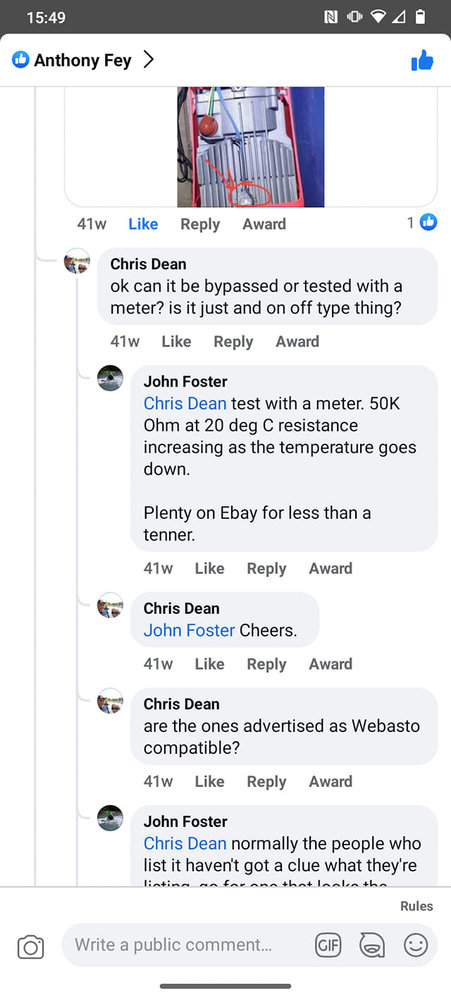

Picked up a heater FOC non runner.
fan runs, pump pumps, glow plug glows, goes through a short cycle then stops.

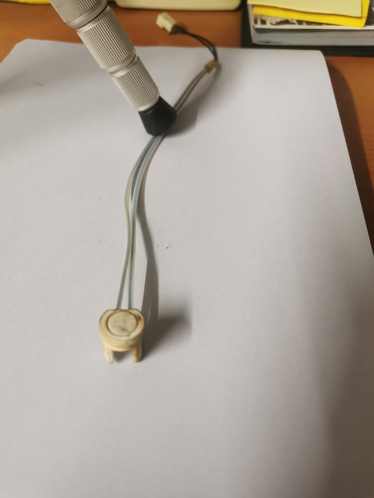

There is a sensor on the outside of the burner it appears to be O/C i presume it is an overheat unit, don't want to just short it out, have found over the years this can be terminal.
If anyone knows if o/c or s/c the norm would be nice or has a dead burner they want rid of.
Here is pick
