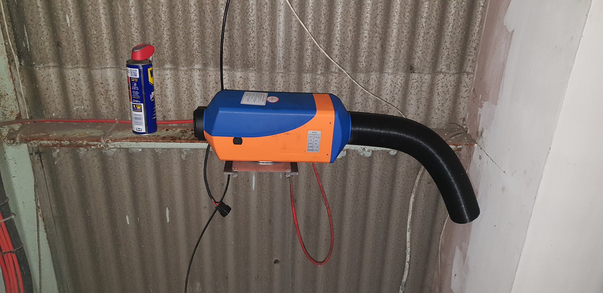

Following this since I've got an '8KW' one on order.
@fizzy Chinese heater specs/link/price please? I have a bathroom infra-red one above the 'main' bench for when I'm playing at it, but it doesn't do much for the other corners when I'm there.

Fitted a couple of these to boats a short while back. First one worked great, well for a week or so
Second one we couldn't get to fire at all, it was the simple controller and it was just showing 2 LEDs which we eventually found out was over voltage. I measured the voltage and it was fine, around the 26/27v mark. So that was when I wondered if it was a 12v circuit board inside even though it had been sold as 24v and had a 24v sticker on it. Hooked it up to 12v and it was much happier, the control worked as it should regarding the LED display but the pump was hardly pulsing so obviously it was a 24v pump and a 12v heater. Skipper had enough of it and skipped it and bought a Webasto heater which fortunately bolted to the same brackets I had made and exhaust and inlet sizes were the same so they didn't need altered either![]()
Think it is a bit like anything cheap from China, you can get ones that are dead out the box, ones that last a few weeks/months or ones that run for years.
Most of the boats here have Webasto or Eberspacher and they last a long long time, in fact I don't even recall of any packing up completely, I think a few have had new plugs and a clean out but none have actually died as far as I am aware. They do cost 6 to 8x more than the Chinese ones though.
