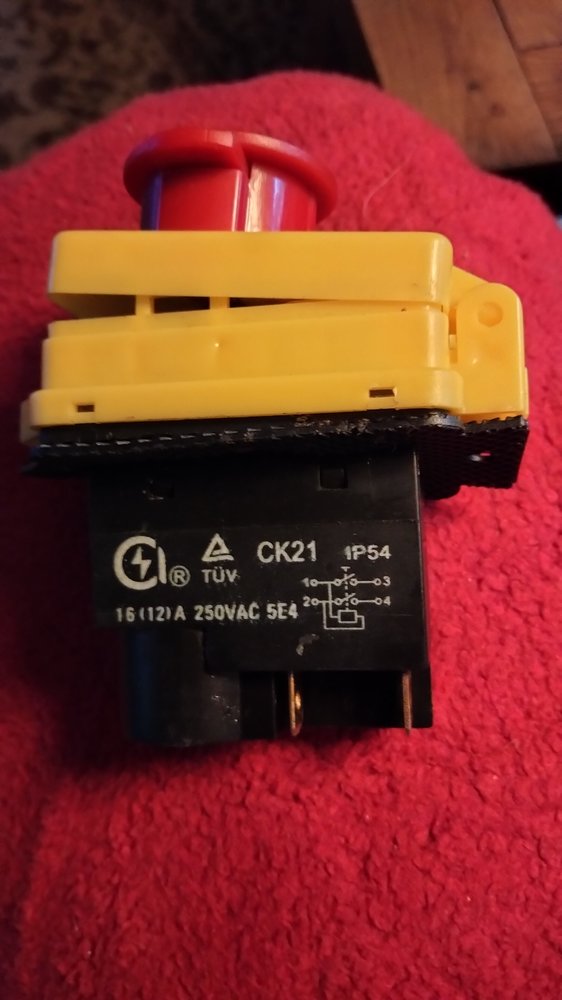

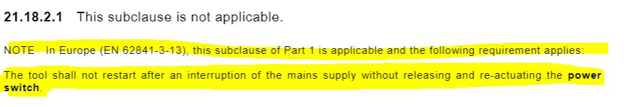

Have bought a unbranded magdrill off eBay. It is generic design that is sold in a multitude of colours, but in escence is the same item. I was a litlle alarmed when I realised that the motor switch wasn't a volt free contactor. This means in the event of a momentary power loss, the drill will detach and then on returning power spin. If it's still in the drill hole, at 550rpm it's going to be pretty dangerous and the switch will just be a blur as it winds the cable around itself before it drags out the plug?
Also if it the magnetic clamp detaches due to drill force the same will happen. There is no safety cutout.
I've contacted the Trading Standards office to see what the regulations on this equipment are, and am waiting for their reply.
Does anyone know what reulations are for this equipment?
I have noticed that one version does have a volt free switch, but is supplied from Switzerland (perhaps they are on the ball over there). All the rest don't. It is the higher powered unit the lower powered is the same as others. Maybe it's a power limit related regulation?
