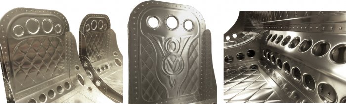

Check out some of the Lazze vids: http://www.lazzemetalshaping.com/in...lts/category_id=5/home_id=5/mode=cat/cat5.htm
