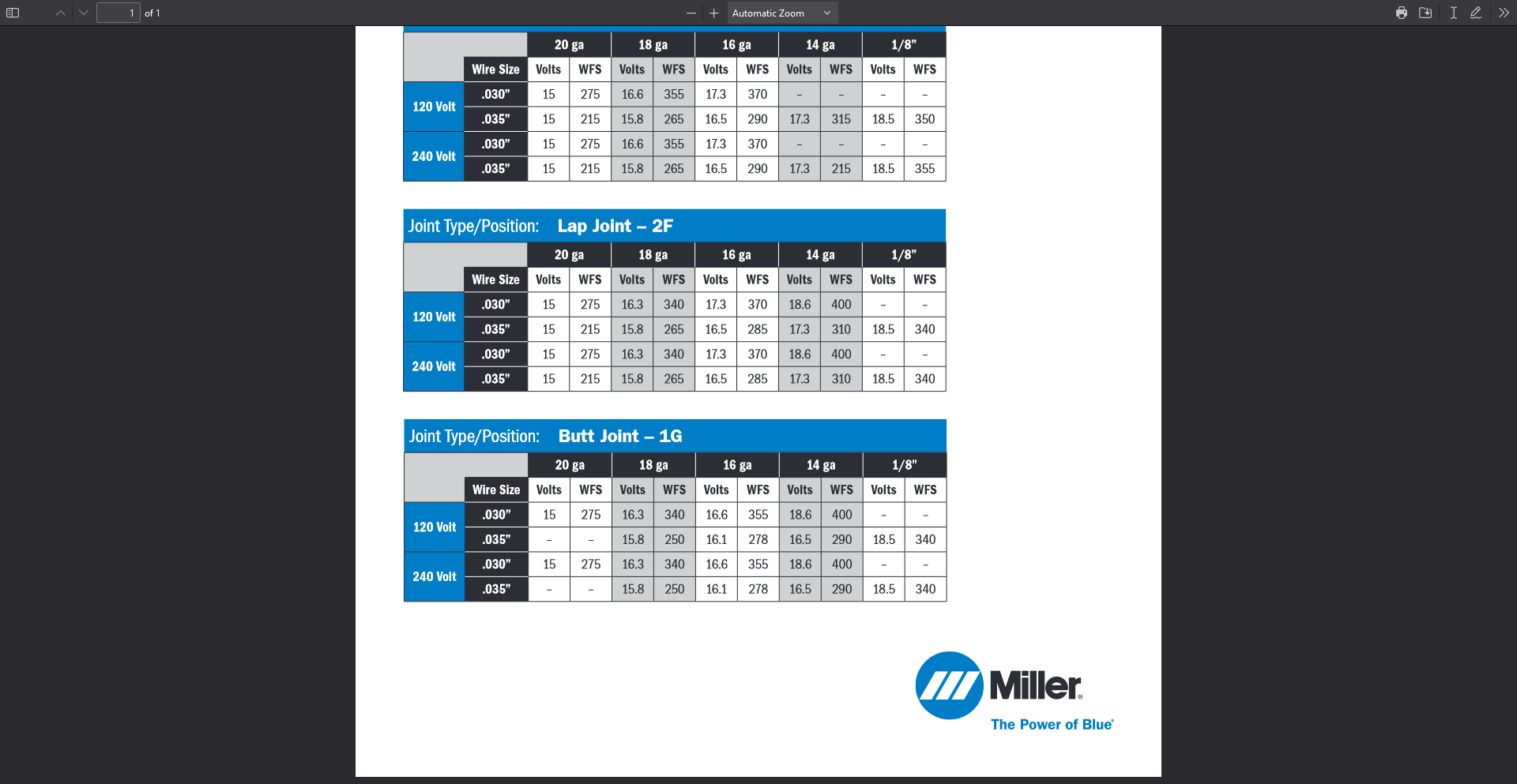

Yours look bang on....
I always use the overlapping tack method, unless I'm welding up rose welds (which need to be slots). I set the machine to 0.5mm thicker than my metal thickness (the kempii is synergic)
