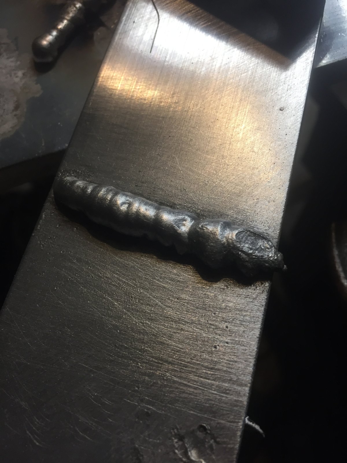

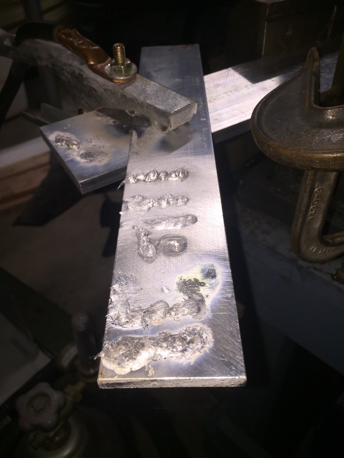

Hope that it runs like a packard after your work just remember to turn panel amps to max when on the pedal as these old machines wont usualy overide the panel amps ie if pamel at 50 amps you only get 50 with the pedal floored you will need about 150 amps for 3mm to get a puddle going .floor the pedal then back it off as needed
