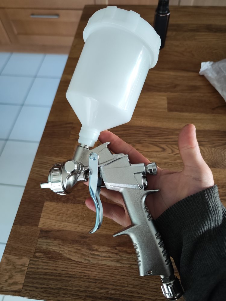

Thanks @Kram

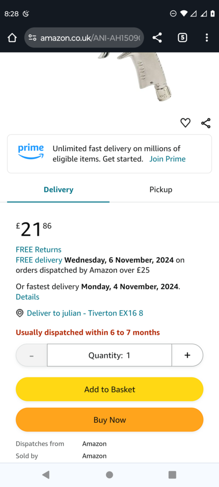

I bought the
Ani Ah1509003A Aerografo F1/N/S 1.8mm
https://www.amazon.co.uk/ANI-AH1509003A-Ani-Airbrush/dp/B0862T9V6F
At less than £22 it must be worth a punt!
I will try and spray some hammered paint with it as soon as it is not raining!
I ordered the last one they had for immediate dispatch this morning. It will be here in a couple of days.
This one arrived yesterday.
