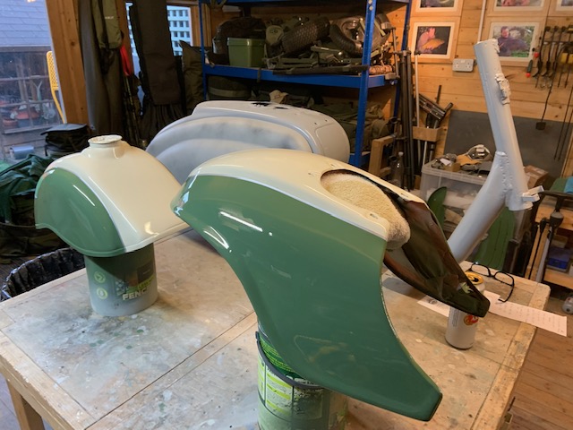

Thanks @KramIf your only buying one gun, there is another consideration, will it do primer? That often wants a much larger nozzle to avoid over thinning. Therefore you want a gun with a 1.2-1.4mm for base and clear, plus a 1.7-2mm for primer. If the gun comes with, or has spares available..
I have two Ani's, the R150 mini gun and the much cheaper GF3 mini gun. They use the same body, main difference is quality of the nozzle.
No mini guns seem to have large primer nozzles available, so I modified the cheap GF3 nozzle to be ~1.7mm
I prefer the mini guns but, I generally only do small parts like motorbike stuff.
