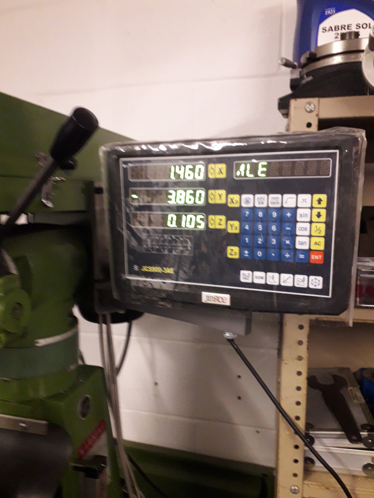

Why, what does that digit do? Constantly flicker or change??

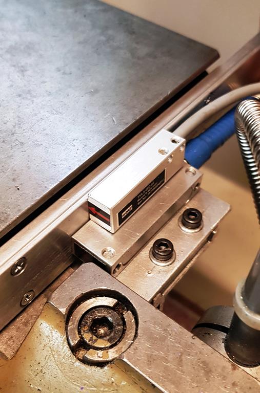

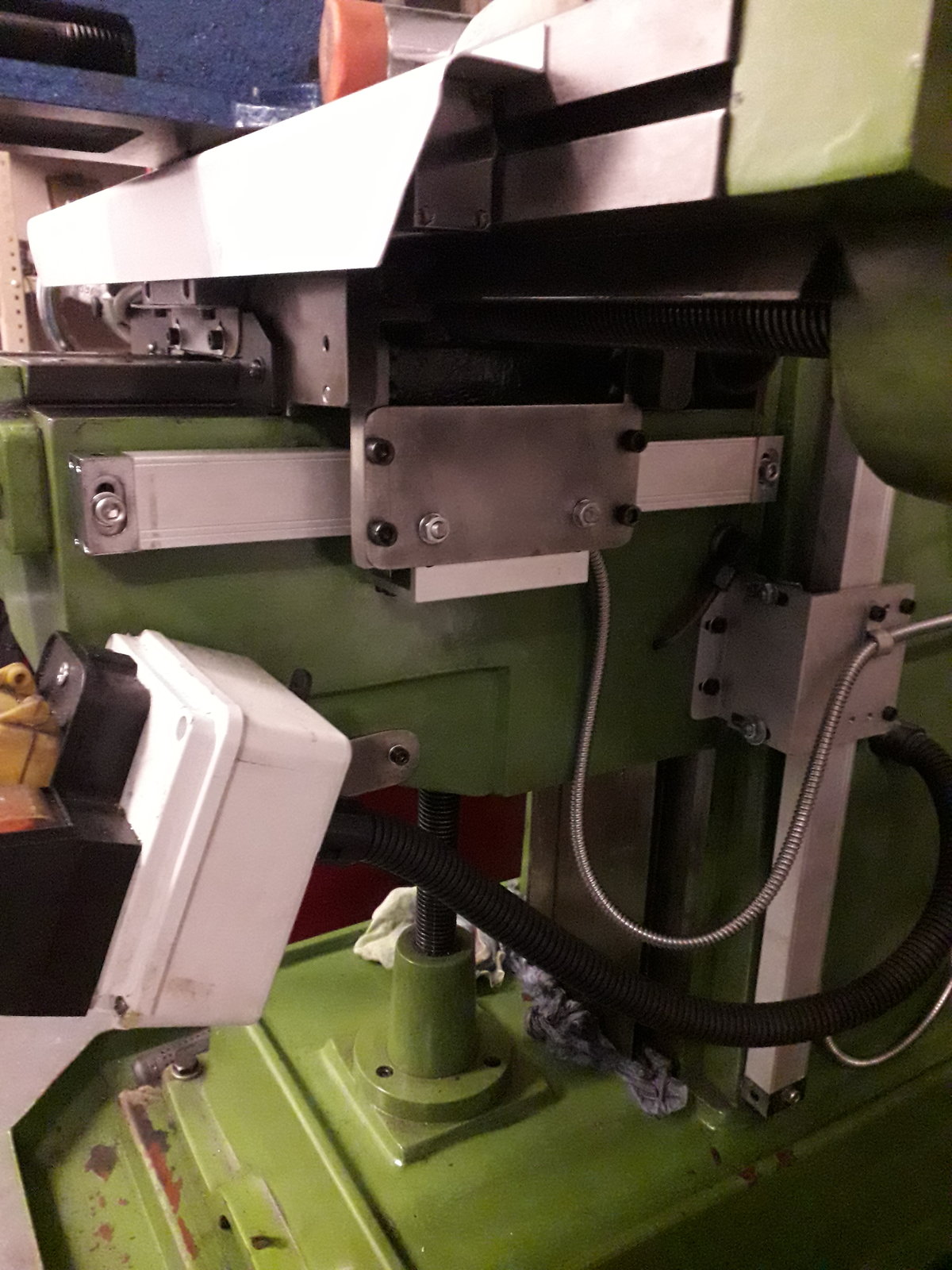

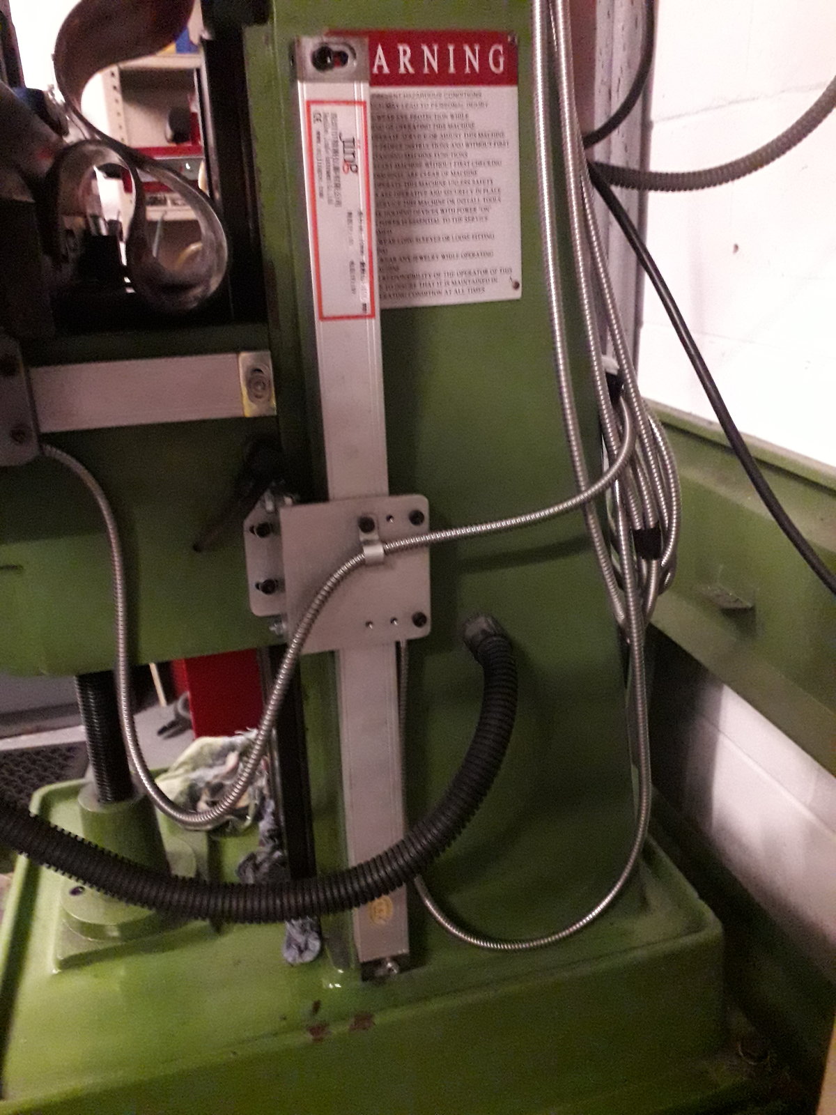

I don't know. How much is your time worth? I try not to make scrap and I am very busy. Over the last couple of years I have installed a new DRO to the lathe and replaced the read heads on the Mill. I have used magnetic read heads and they are far better than the glass scales. In my opinion.
Piece of Insulting Tape over the digit?

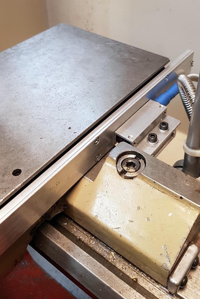

In practical terms, what this means to me is a very low profile magnetic strip on the cross slide and a small 40mm x 10mm x 12mm read head. A word away from a bulky glass scale. I will get a pic.
