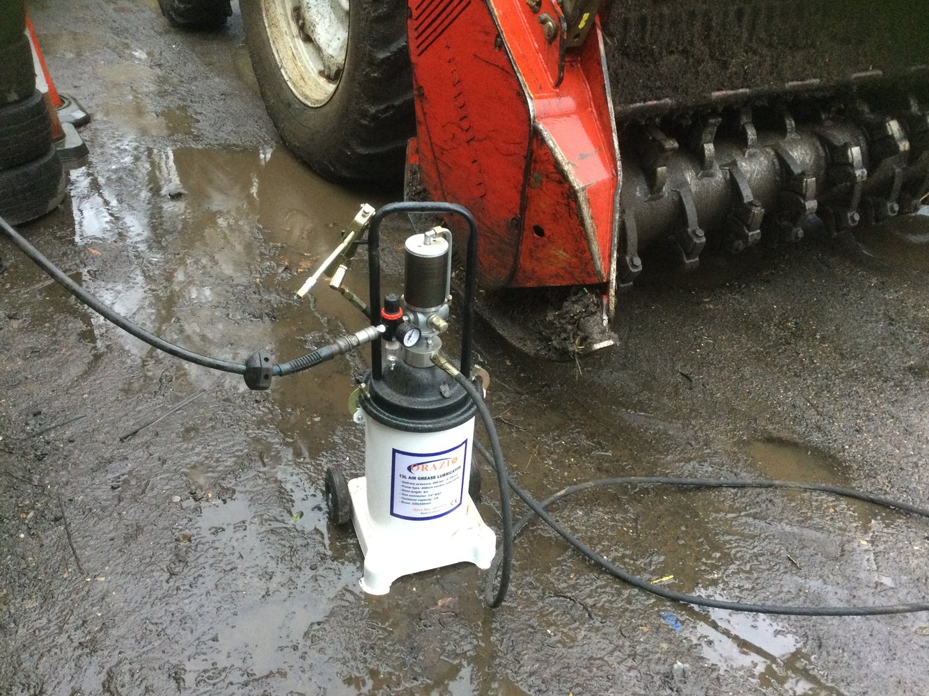

The pneumatic tub grease guns are considerably cheaper than a high end cordless and you wont be running out of grease or battery. Zero mess

I understand your reasoning.I have mixed feelings about cordless grease guns, its bad enough having a cartridge run out halfway through a grease up, add a battery going flat into the mix and there is a temptation to launch the thing into outer space.
Bob
Not much at all.How much pressure does it require on the handle? Relatively easy to pump?
