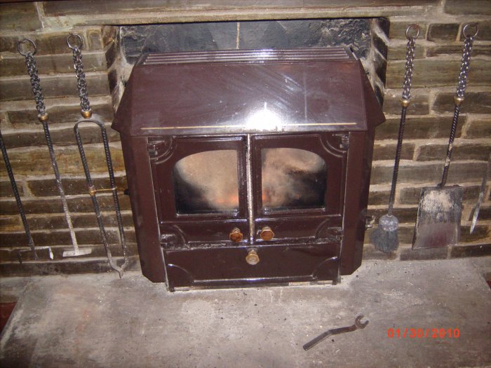

Had a prob the other day with the above, the boiler started leaking water out onto the hearth. Turned the water supply off and drained it down, cleaned up and phoned the building insurance. Although the insurance does actually cover fixed heating appliances, they said no help as the stove is more than 10 years old and it is suffering from 'wear and tear'. I had actually thought they would help me a bit with the price of a new one
. Anyway, sick as a parrot and after telling the mrs to cancel the direct debits to the insurance, I started to examine the boiler with a scraper, wire brush and chipping hammer, I had soon managed to knock a hole through the weak eaten part. I dented in the thin edges and found that the surrounding area was'nt so bad, so I brought in the IFL and 4" angle grinder, I found that I could do 4 sucessful welds in about a 3" square around the hole with 2mm 6013s then starting at the back vertical weld and stopping at the front v weld I slowly built up from the bottom, after quite a few rods and bit of grinding I have a reasonable sound boiler again, none the worse of its clean up of course, and heating the radiators fine again. Just wonder why it was eaten through in only 1 place? I checked where I could and can't find other bad spots on it.
