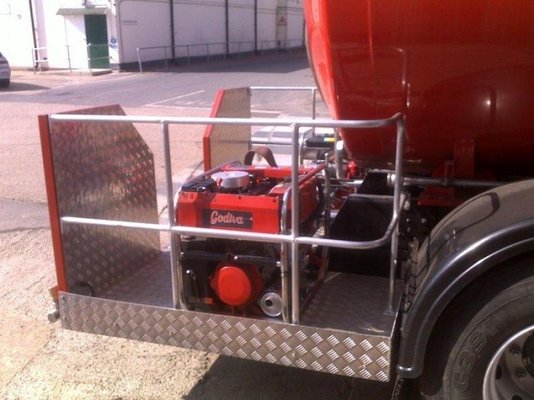

With the new info I would recommend using the one bat out of the two in the 24v system for the 12v starter.
Using a starter whilst being a high amp draw of about 300amps it is only for a few second say 10 at most. Thats less than 1 ah used per start. Your looking at less than a 1% imbalance at worse case. You could also remove the alt from the secondary engine & save fuel.
That or change the starter for a 24v one.
