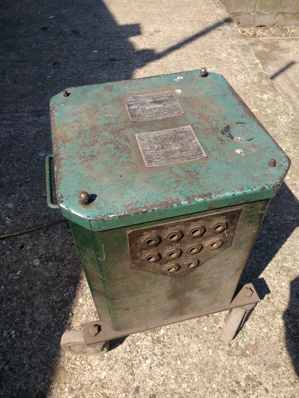

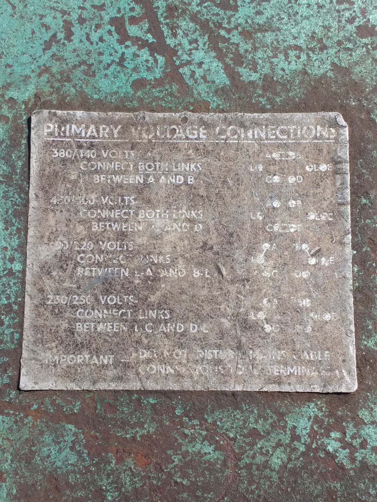

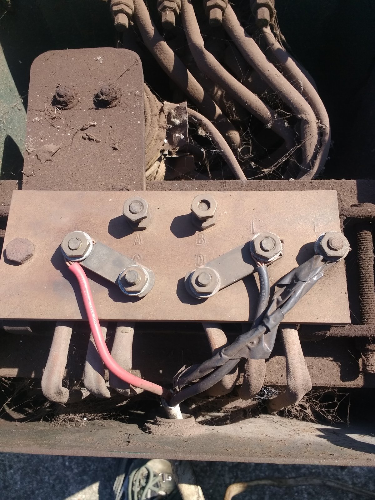

Connect both link between A and B that's said on the chartAnyone got a welder something like the one below? Want to configure for 400v
I think the links need to be a and b with the 2 lives on the 2 l terminalsView attachment 176101 View attachment 176102 View attachment 176101 View attachment 176102 View attachment 176103
