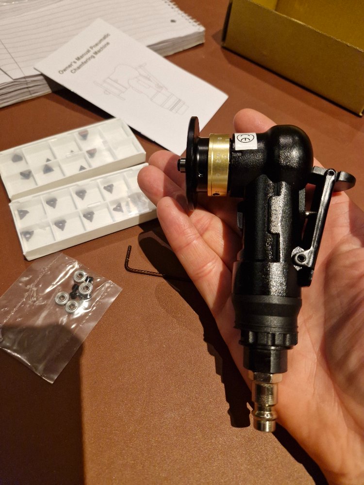

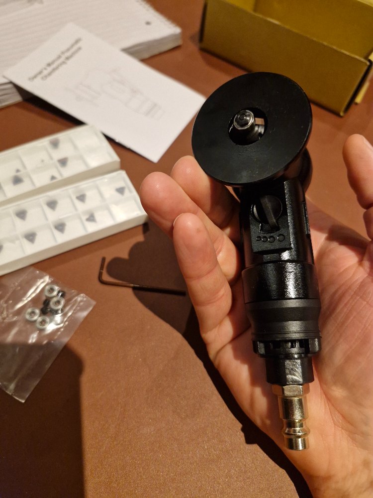

Mine has a red arrow on top showing the rotation. Clockwise.What's the proper direction? Mine didn't come with anything except a parts diagram.

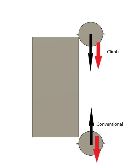

Assuming a clockwise rotation looking from above, pushing the tool away from you with material to the left of the tool would be a conventional cit
