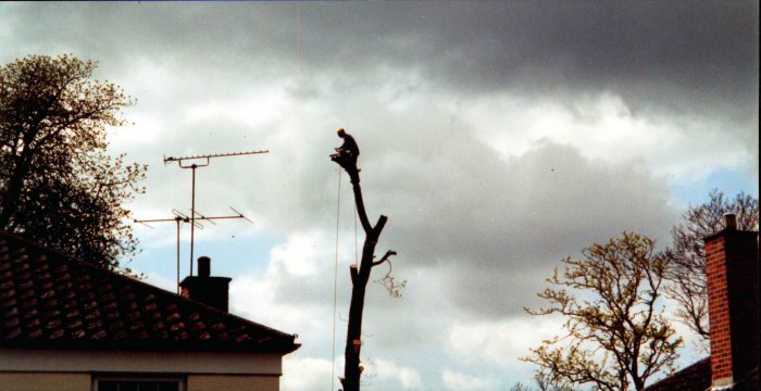

one way of blocking the signal to sumones tvYes, a great way to make a living, for a young fit person.
Me sectional felling a horse chestnut in a back garden, height: about 50 feet.

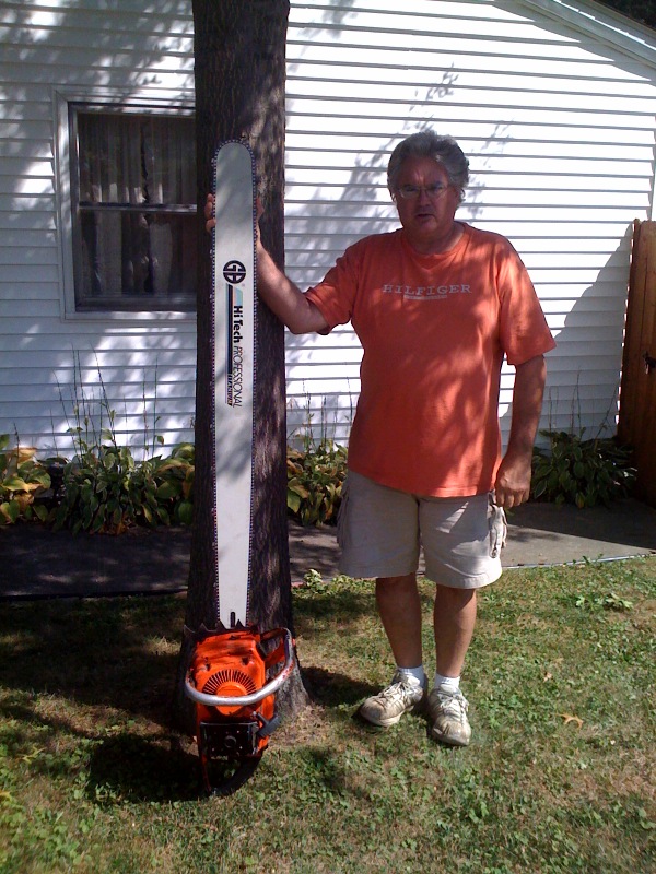

Edit: The only issue you might come up against is with big saws with long bars, if you sharpen by hand you might find the long saws making a curving cut and jamming, this is caused by one side of the chain being sharper than the other as is easy to do with hand sharpening, due to left hand versus right hand differential. A machine eliminates this problem which is most noticeable on the big saws.
I have a couple of sharpeners, some better than others. I just bought an antique one like my dad used 30 years ago...Bob
