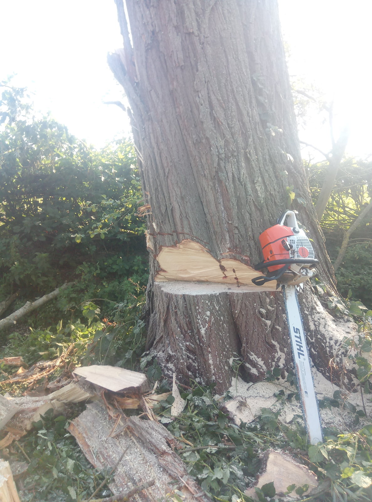

Think I've sorted the oil feed prob , tipped the old oil out , squirted penetrating oil in and refilled with my chain oil , chain seems damp now ....
