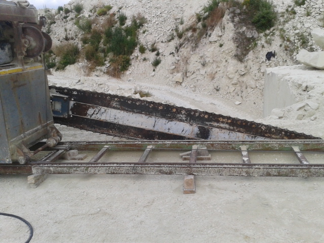

Would you need an override switch in the circuit to bypass the voltage monitor relay until the saw is up to speed? Otherwise the circuit would never start!
no, the trip is on the saw traverse motor (I think). It would just prevent the saw from being driven (i.e moved on it's rails as the OP put it, not the chain drive) unless the chain is spinning - you would start the chain, which would then engage the voltage monitor and allow you to traverse the saw. I hope that's what the OP was talking about anyway!Would you need an override switch in the circuit to bypass the voltage monitor relay until the saw is up to speed? Otherwise the circuit would never start!
no way, I have a 2 year old, I've been up for hours!!I thought that as soon as I saw it, probably still on his first cup of coffee?![]()
no, the trip is on the saw traverse motor (I think). It would just prevent the saw from being driven unless the chain is spinning - you would start the chain, which would then engage the voltage monitor and allow you to traverse the saw. I hope that's what the OP was talking about anyway!
you could be right but that's not what he asked for. He wanted something to stop the saw mangling itself up (I.e mashing itself against the stone rather than cutting it) if the chain stops. The tacho would be attached to the chain drive (Perhaps that bit wasn't clear) which monitors the chain speed. If the chain stops, the saw cannot move (Traverse).I think it would be better incorporated into the chain drive circuit as it would cover any problems with the chain?
Yes, the same arrangement could be put into the estop circuit, but the general idea would be the same.OK, we'll wait for feedback from the OP, I just thought stopping everything, chaindrive, traverse, etc. would be safer?.
I did a course at Sick about 10 years ago and the one thing I learned is that doing things like this opens up a can of worms when modifying old machinery.
I cringe at having to make on the fly software changes to things (I don't get involved so much in the hardware side of things now since I changed jobs last year) without having some sort of authorisation - the way I understood it was that the machine as a whole was CE certified, and any change to anything (electrical, mechanical or software)could potentially affect that. I could have got the wrong end of the stick but that seemed to be the gist of what the guy running the course told us.Sounds similar to one I did at Pilz, covering machinery directive, CE marking etc., my boss wasn't too happy to find he couldn't stick CE markings on machines without any supporting paperwork!![]()
...the way I understood it was that the machine as a whole was CE certified, and any change to anything (electrical, mechanical or software)could potentially affect that.
That looks like it would have your fingers off in a jiffy!![]()
You can, but it needs to be done right. If you add a cutout which then inadvertently restarts you have in effect made it "less safe".You can add a cutout, so long as it doesn't interfere with the operation of the fitted stuff.
