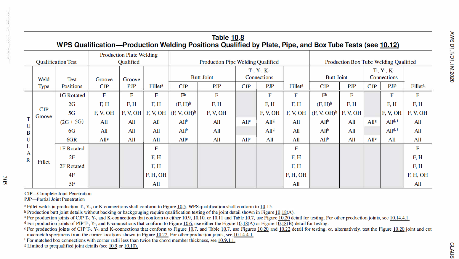

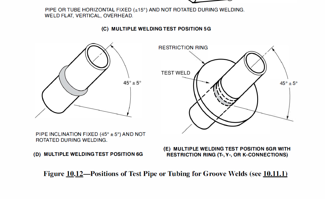

Same as above ^^^A 6gr pipe weld does not , imho allow you to weld structural steel to en1090 .
It allows you to weld pipe joints in all position , or have I missed something ?
