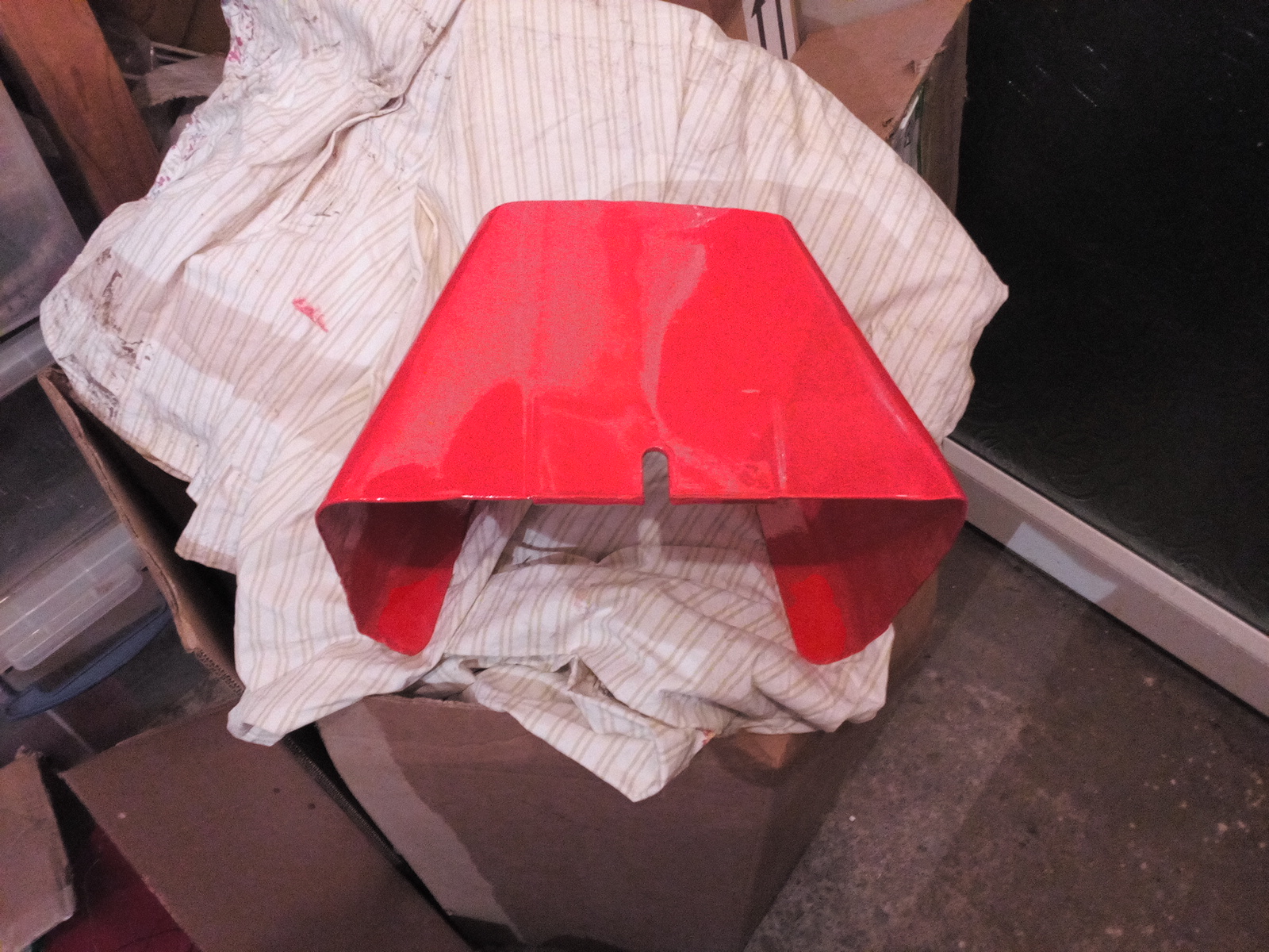

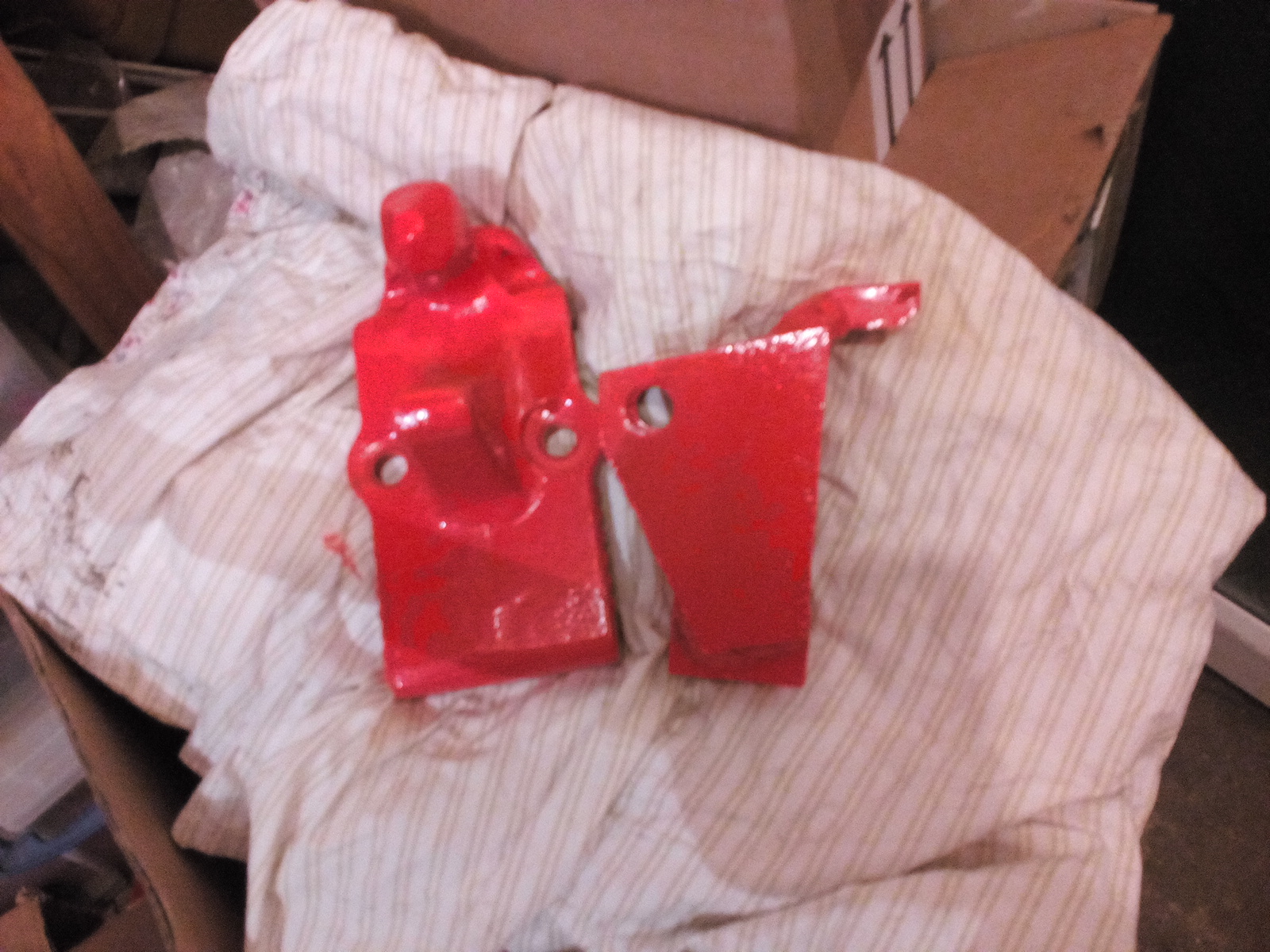

Synthetic enamel does not need a lot of thinning I have been using vapromatic and 10% thinkers is ok but to get the shine you need to build the coats up these were done the other night
Vapormatic paint is well regarded as well. I have used it & it seems to dry quicker to a harder finish than the tractol, though I can't comment on durability as I sold the stuff I was painting - 2 sealey welders! MF super red is a close match to sealey red!
Personally I like the tractol paint, cheap (£10 per litre), easy to apply & dries to a tough durable finish. Restorers say that their colours are not a good match to the original tractor colour, that doesn't bother me as I don't paint tractors!
