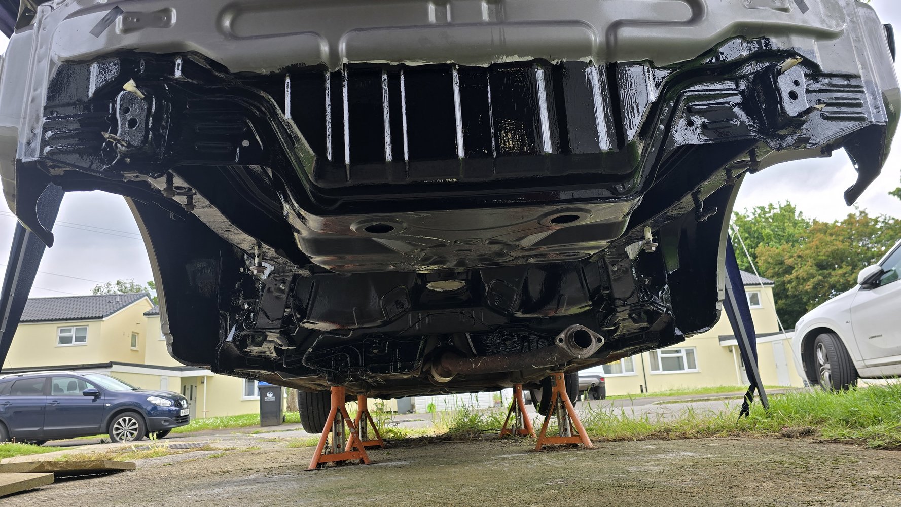

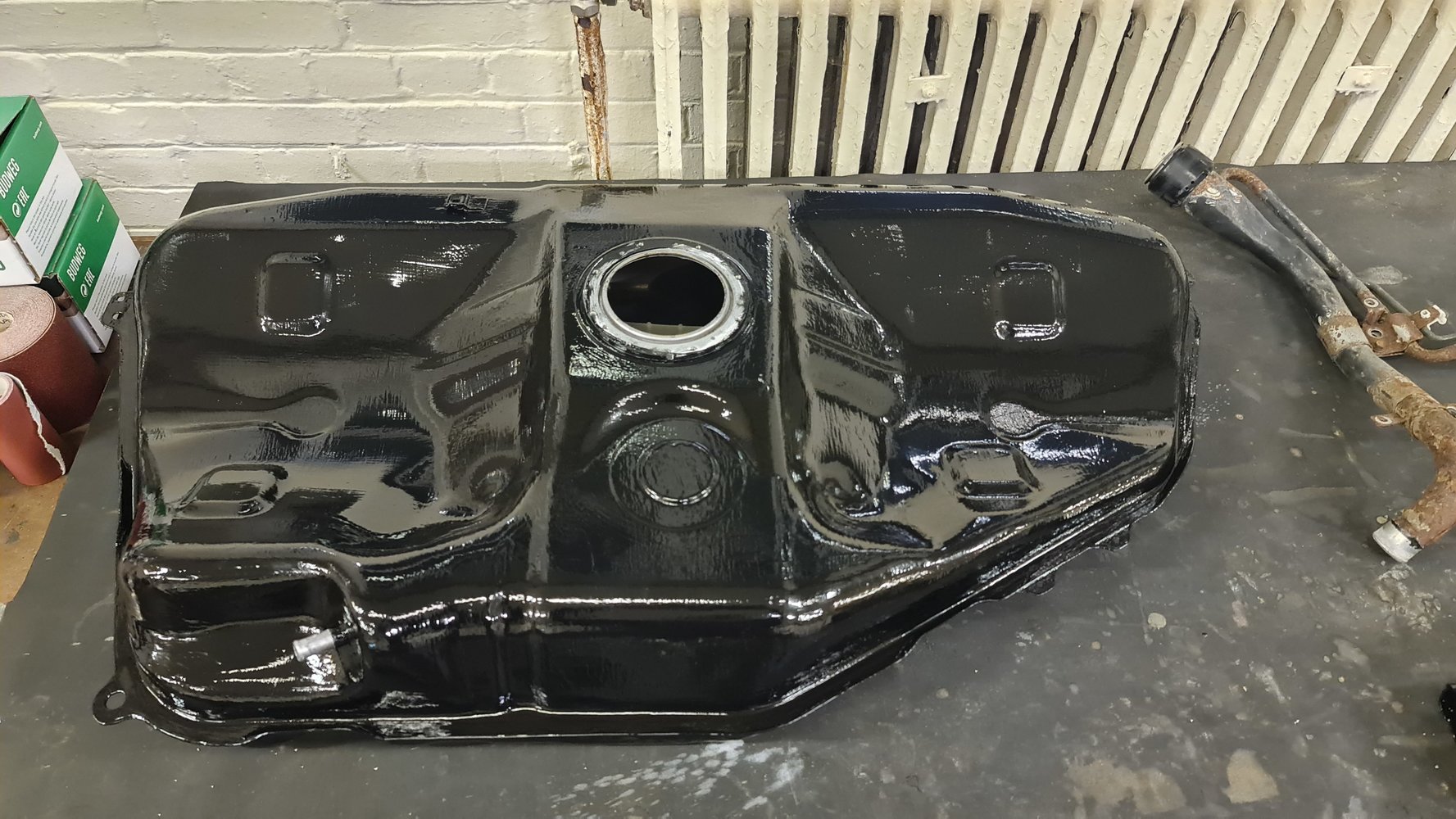

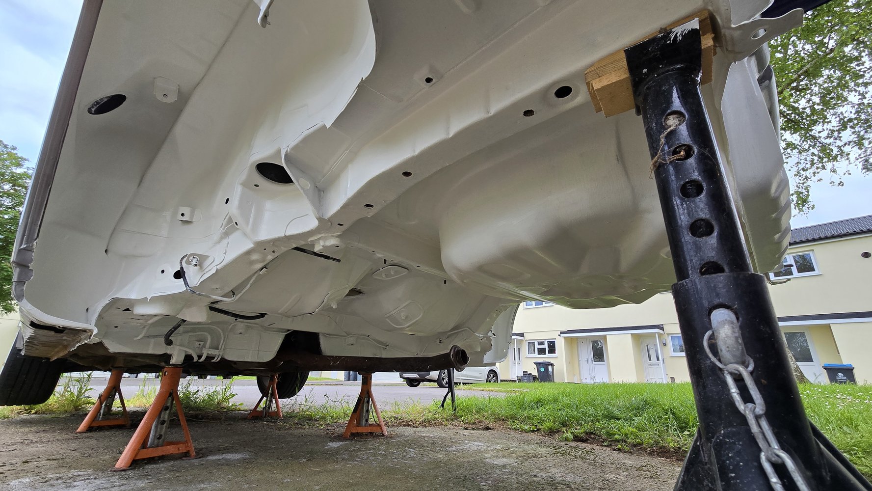

Close up it doesn't look sprayed but it's a field tank under the car so don't mind. Jotunmastic 90. Decided to go a light colout so i can see if the hardtop chips off its easily noticeable.What's the white paint you used? It looks sprayed, though I know you said it's brushed on. Looks great with the black on.

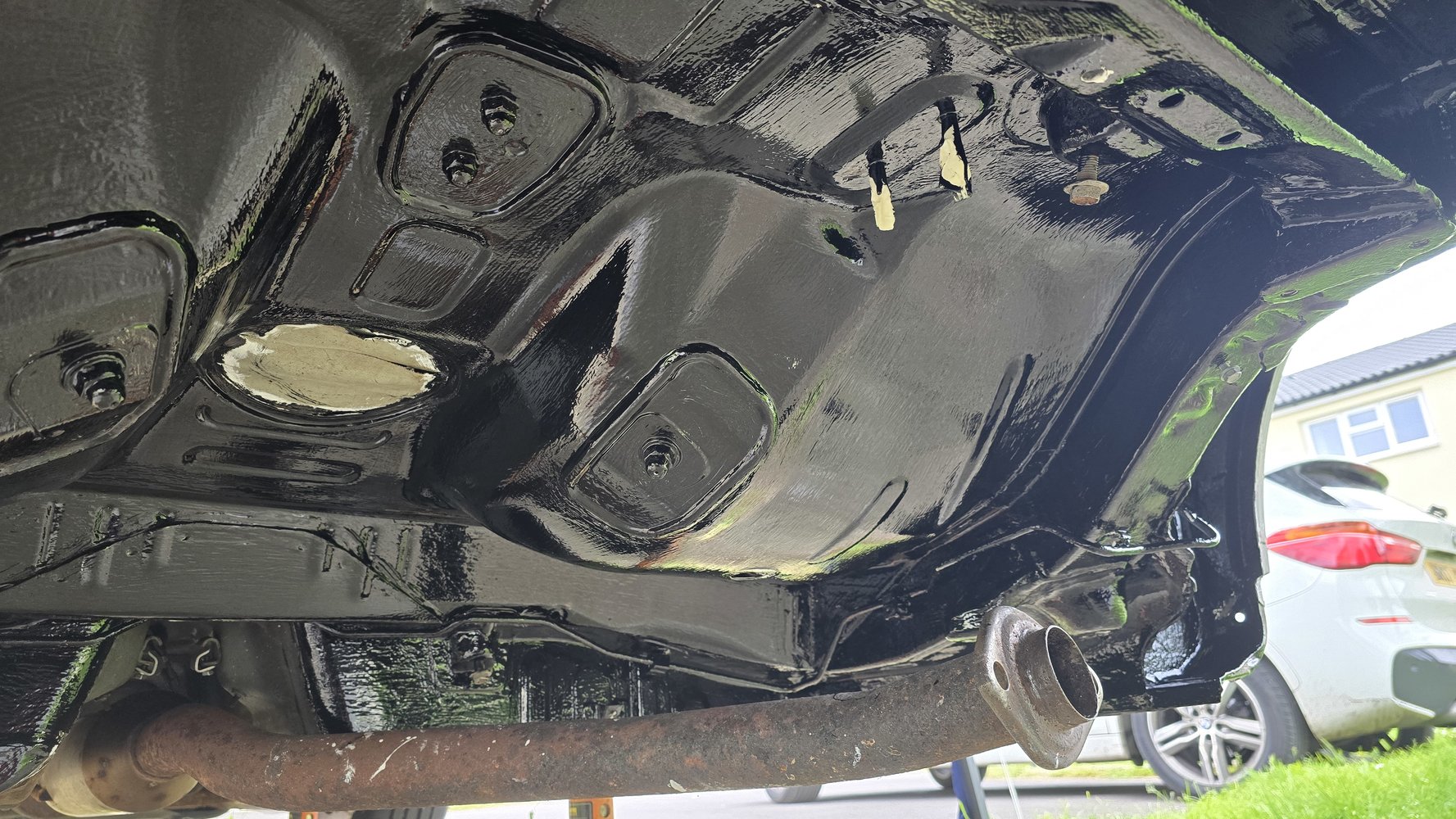

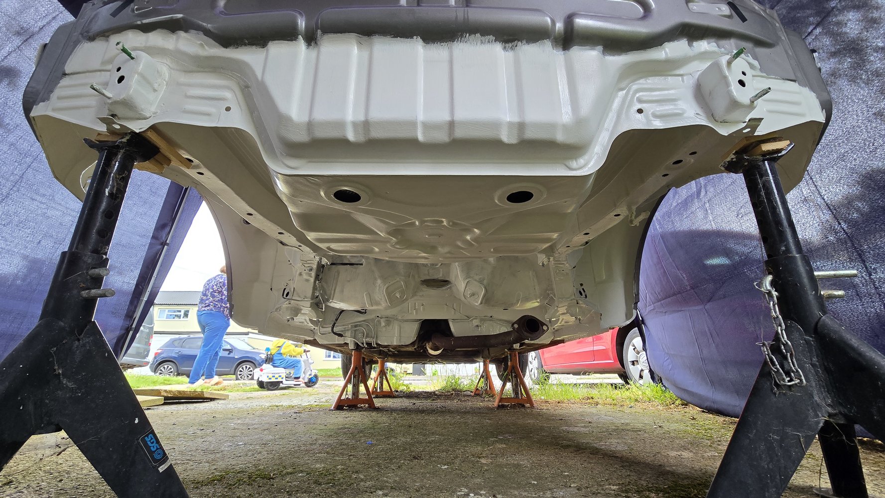

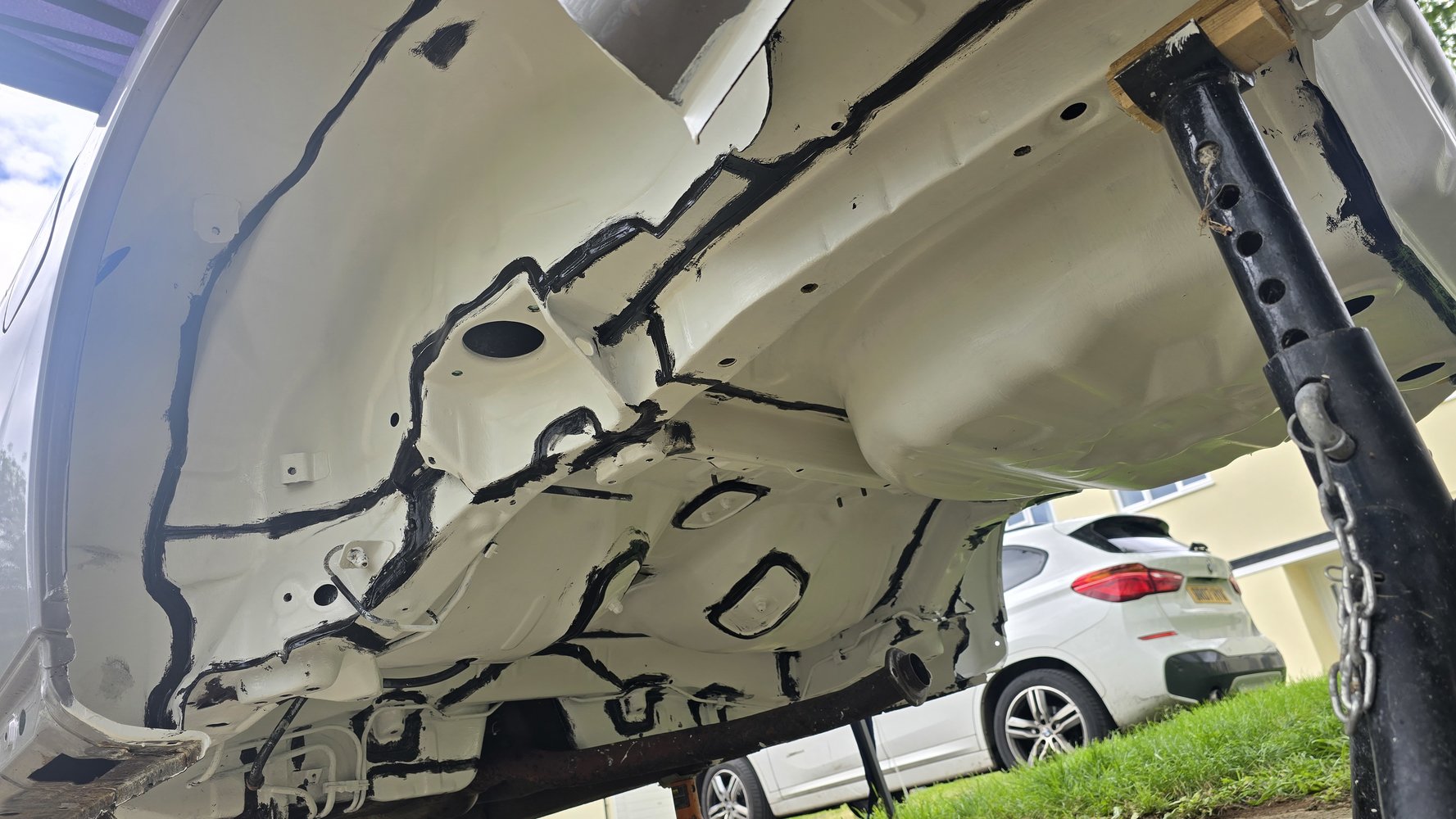

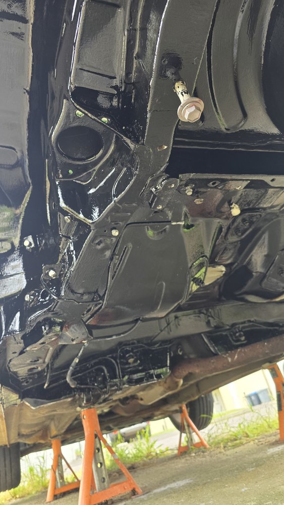

Tiger seal I find is very good but as said it can be difficult to apply. Good work.Seamed sealed ready for painting tomorrow. No the tidiest, but it was hard to get the gun in places and also tiger seal is a nightmare to use....
