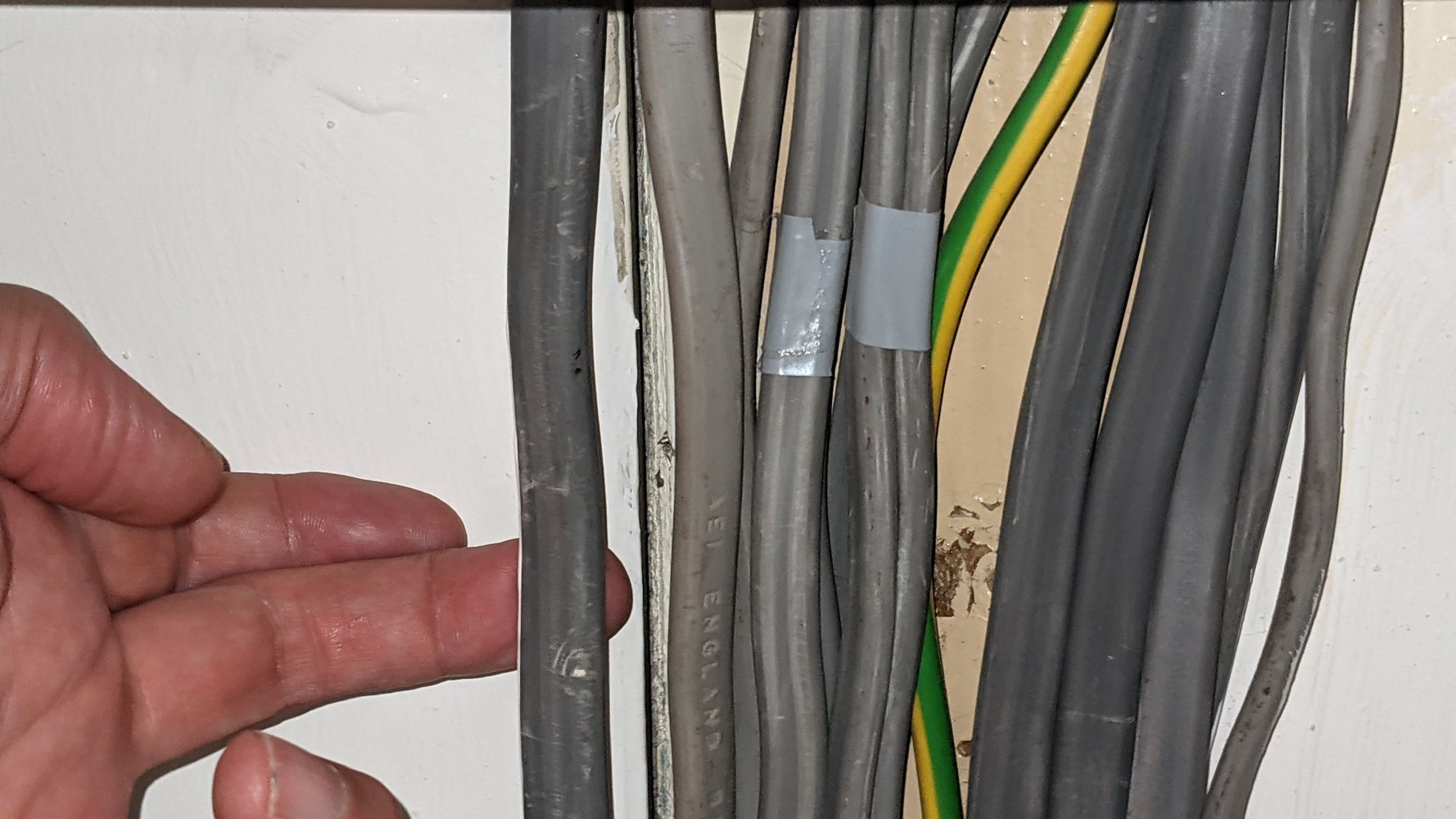

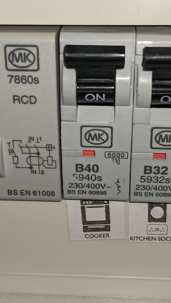

Here is the oven cable, no way it's 6mm.
shouldnt have a 40a breaker on a 2.5mm radial or a 2.5mm ring for that matter so whoever bodged it did a proper job. Maybe it was the same person who wired our place.

? current carrying capacity of a 2.5mm twin and earth cable/ installation method/ grouping factor. Wouldn't be normal to run a 2.5mm radial in twin and earth and protect with a 40A MCB. 2.5mm ring should be protected wtih a 32A device or smaller?How have you confirmed the cable size in question before slandering the person who installed it?

Right enough could be 6mm2 or maybe a 4mm2, took it that Race Diagnostic reconed it wasn't but its hard to tell from a picture.I mean, how have you confirmed that the cable which has been installed is 2.5mm?
From the picture that could easily be 6mm.
My oven runs off a 13amp socket. It's the electric hob that needs a high current supply which surprised me. That choice of breaker is pretty scary thoughThis is the existing oven breaker. But no way it has a high current cable, looks like a 13 amp circuit cable.
