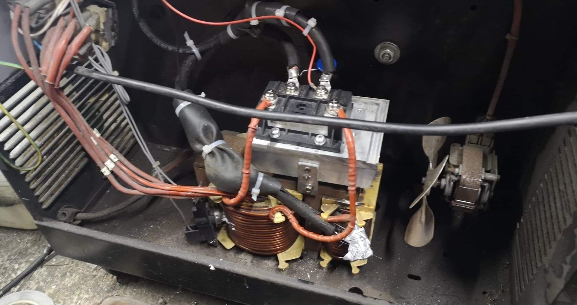

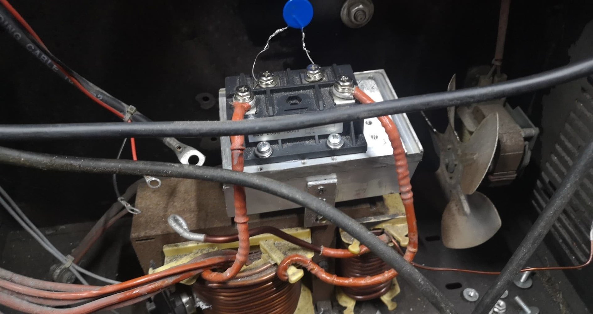

i take ur point dissasembley would incur damage i feel,,i am bidding on the heatsink fan job to mount 200a bridge rectifier .what would be really helpful is the wiring which bits go where please ? oh final thought do i need capacitors to smooth output can the ones be used of old unit ?This eBay listing has the dimensions for the "MDQ-200A" bridge rectifier block that I mentioned in post #15:
It is 94 x 73mm overall.![]()
MDQ-200A Bridge Rectifier 200A 1600V Single Phase Full Wave Diode Module | eBay UK
Average Forward Rectified Current: 200A. Bridge Rectifier only, other accessories demo in the picture is not included! 1 x Bridge Rectifier. Phase: Single Phase. Mounted Hole Dia.: 5mm/0.2in. Made of high quality material, solid, durable, good performance and high power.www.ebay.co.uk
This website has details of a similar diode/thyristor block to the ones that are already mounted on the eBay heatsink:
That block is 92mm wide. As johnrev said, those two existing blocks would have to be discarded, and replaced with a new 200A 4-diode bridge.
The fan fitted to that heatsink is 240v, so it would be easy to wire up.
I think that two of the paralleled diodes in the main 4-diode bridge rectifier have failed? If so, then in theory you could ignore the "inductor feedback circuit", take the two diodes from the small square top plate, and then use them to fix the main 4-diode rectifier.
However, that would be a difficult job. Pressing the diodes out and back in to the new positions may break them. It would be liable to confusion of the exact placement of the connecting shims, and those shouldered ceramic insulating washers often disintegrate when the mounting studs are loosened.
