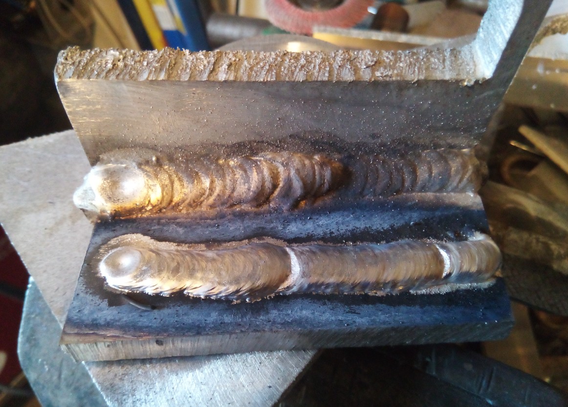

Ok so powered it up with the 0.8mm wire that was in it from Toms testing, the synergic line says 0.9mm or 1.0mm for Alu so it was set to 0.9 and when I cranked up the dial I was a bit sceptical that the max it said it would weld was as high as 6mm Alu, but when I set it up for 1.0mm wire and cranked it up I had a wee chuckle as it said it would do up to 14mm, aye right

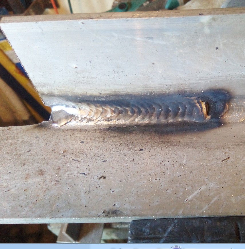

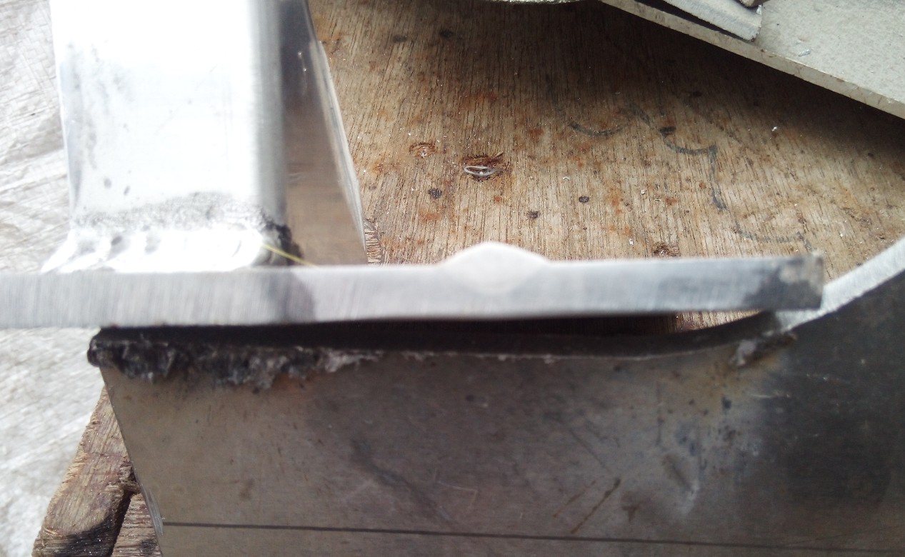

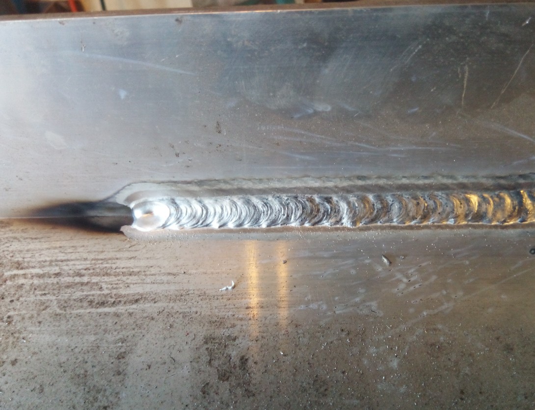

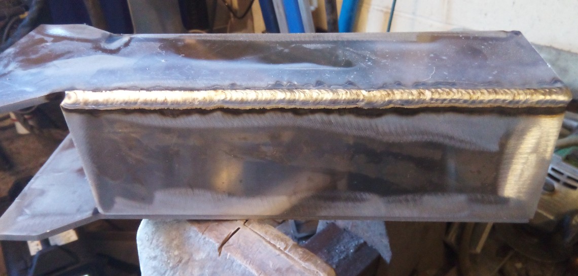

Ok so back to the 0.9 settings and set it for 6mm and I grabbed a bit of 6mm from the scrap pile and gave it a blast, it was far too hot, I couldn't believe it. So I had a few more practice runs winding it down a bit at a time and 5.2mm seemed to be pretty good. I then fetched a new bit of 6mm Alu and did a run on the surface and then I welded a bit of 3" x 3/16" wall box to the plate as well.
I was very impressed, pic below.

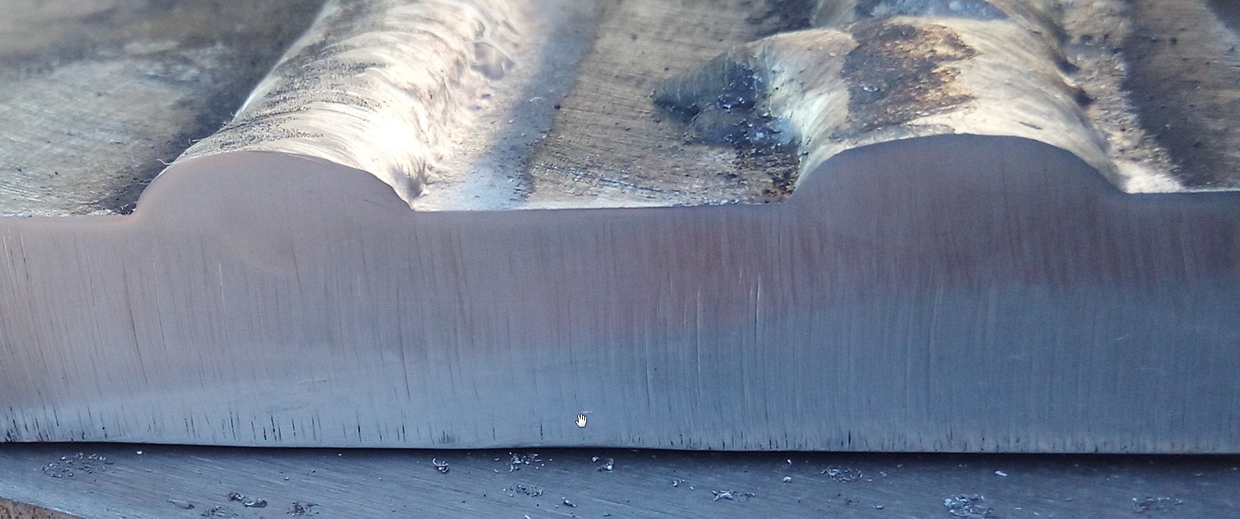

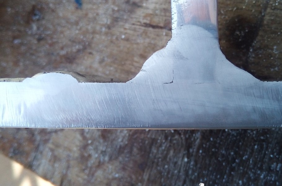

I decided to etch it and see what it was like.
Looks pretty good to me especially from such a small welder.
