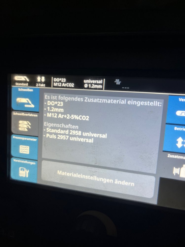

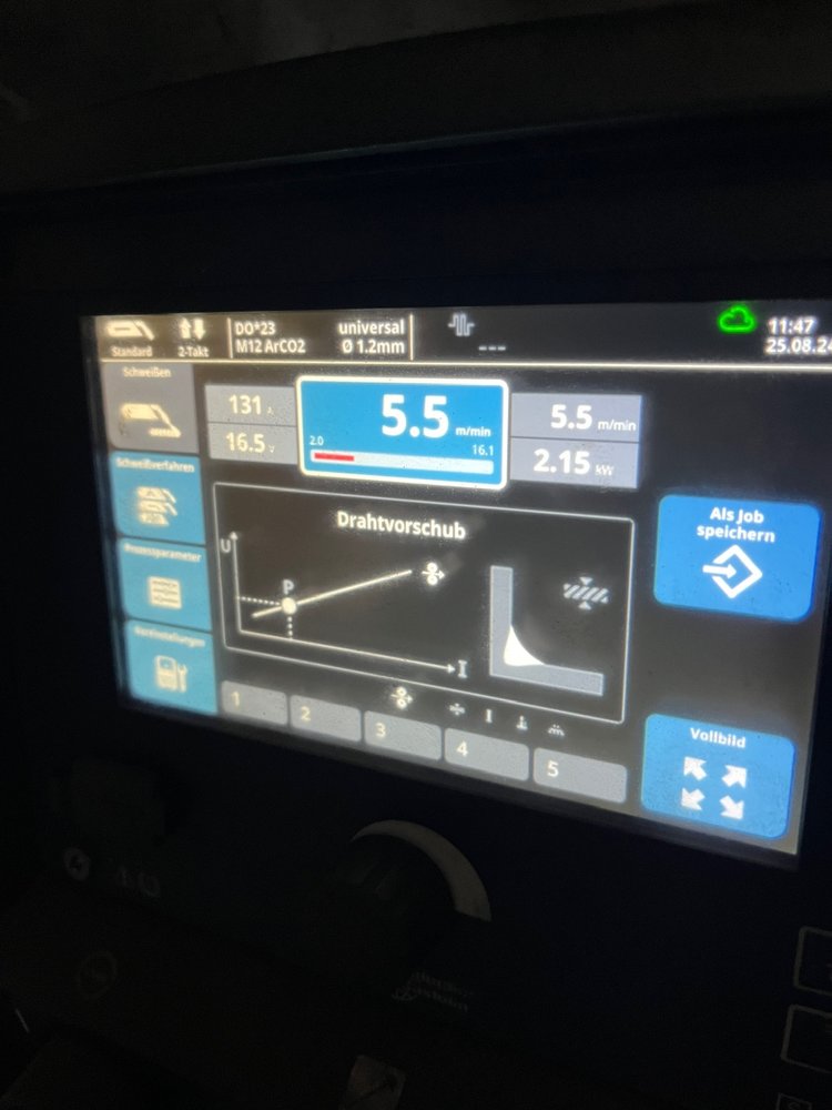

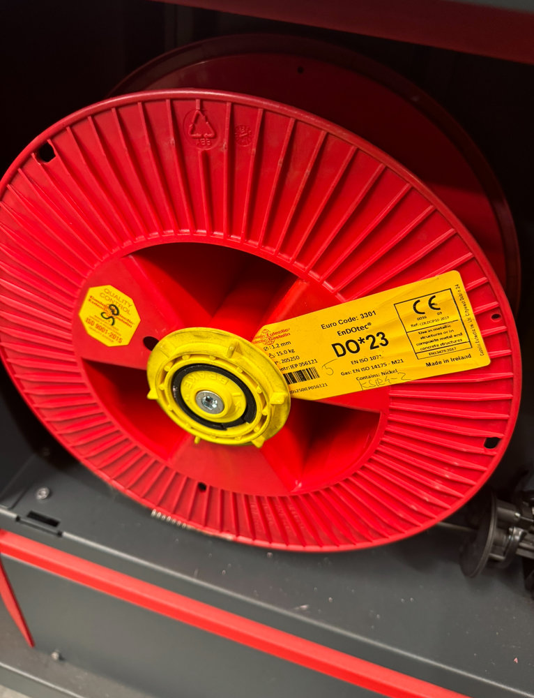

Has anyone got experience running this wire?
It's a nickel matrix with iron, manganese and spheroidal graphite.
Struggling to get a decent arc condition, spatter aplenty.
I've tried various voltage ranges, various levels of inductance.
More wire helps but due to cast iron part i'm trying to keep dilution and heat input to a minimum. 5.5m/min is already up around 150-160A.
@Petros55 maybe you've had a go with it?
Powersource is a fronius TransSteel 3000
