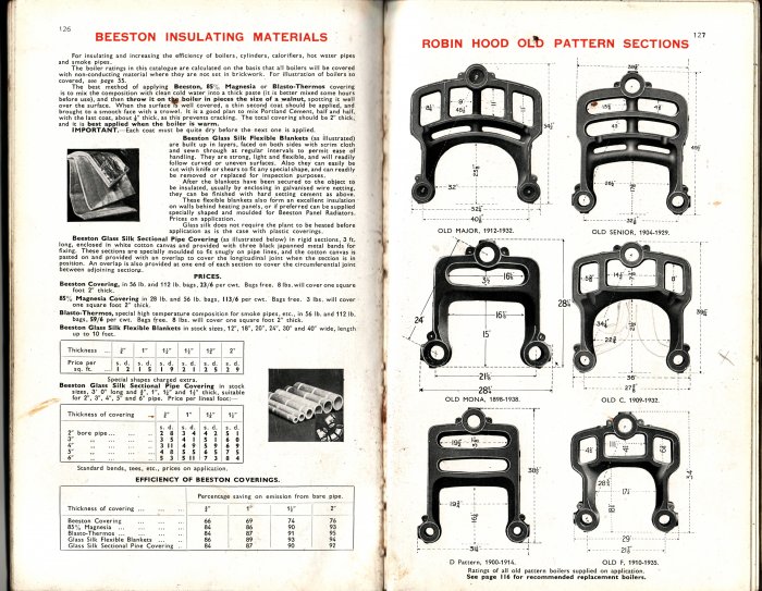

Ive smashed out Robin Hood Boilers and fitted Potterton Isis in place section by section , hard work but intersesting , that was back in the glory days when we were a proper firm with 14 people on the books
The nipples on boilers were interference fit though not threaded , sections were held together with bolts as I recall
Yes and for that reason never let them cool down or they leak 'orribly !!!
