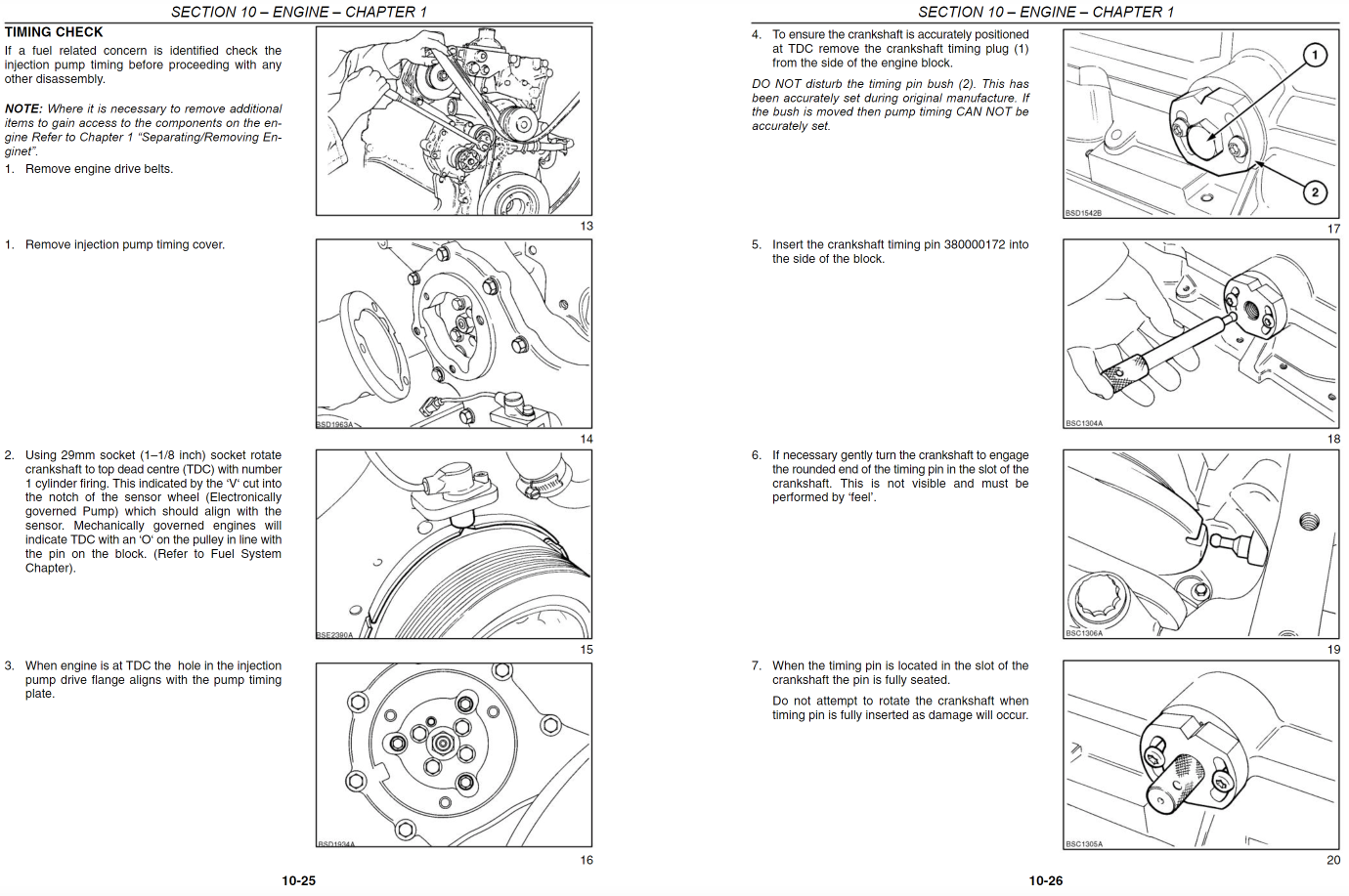

Does anyone, have one of these, Case timing pins, part no.380000172.
I have a fuel pump job , coming off and would like to get the dimensions, of the pin, to get one made. It is not available, from CNH.
Customer, got someone else to fit a replacement pump and it is not right. I want to get a pin, so I can be sure it is spot on.
The pin is stepped, so I can't use a drill bit, as I normally would. Also tractor is 70 miles away, so just want to go and do job, the once.
It is an Iveco engine, from circa 2003, not sure is a Daf truck, might als have used it.
Thanks guys
