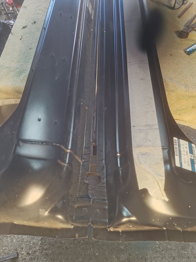

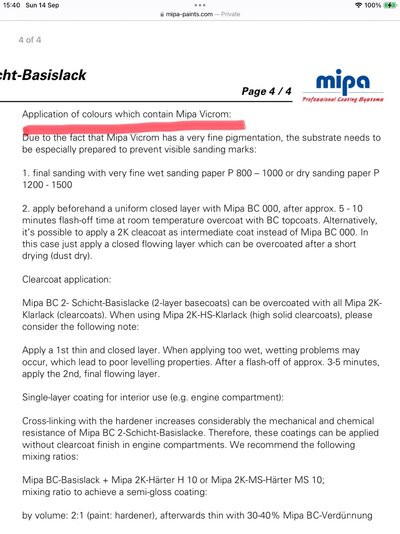

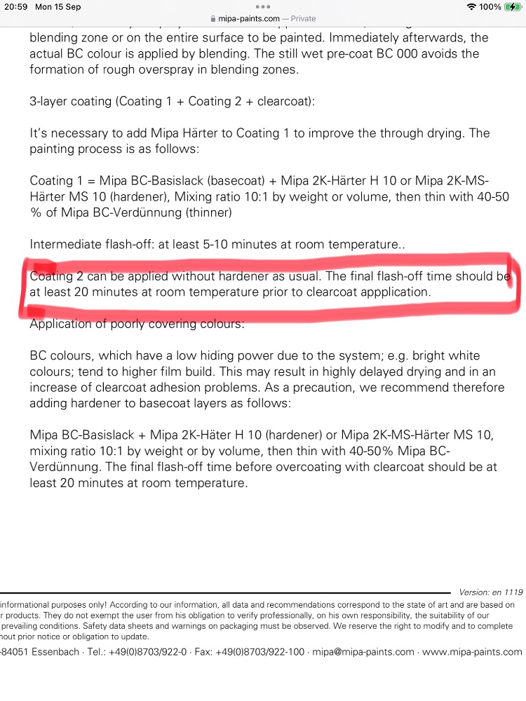

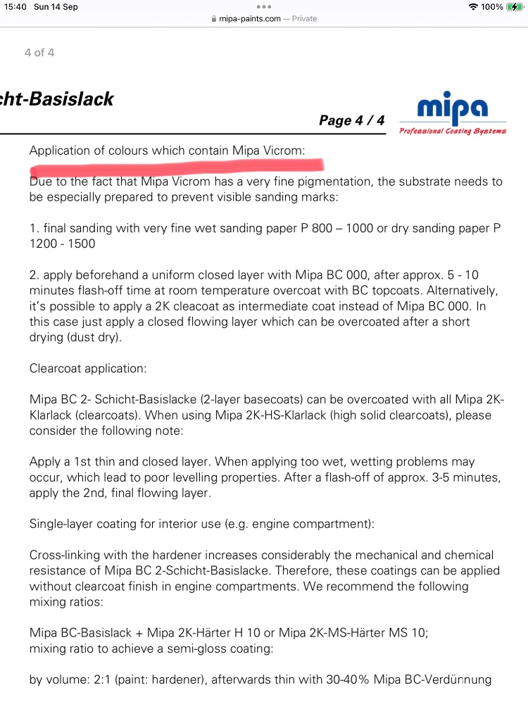

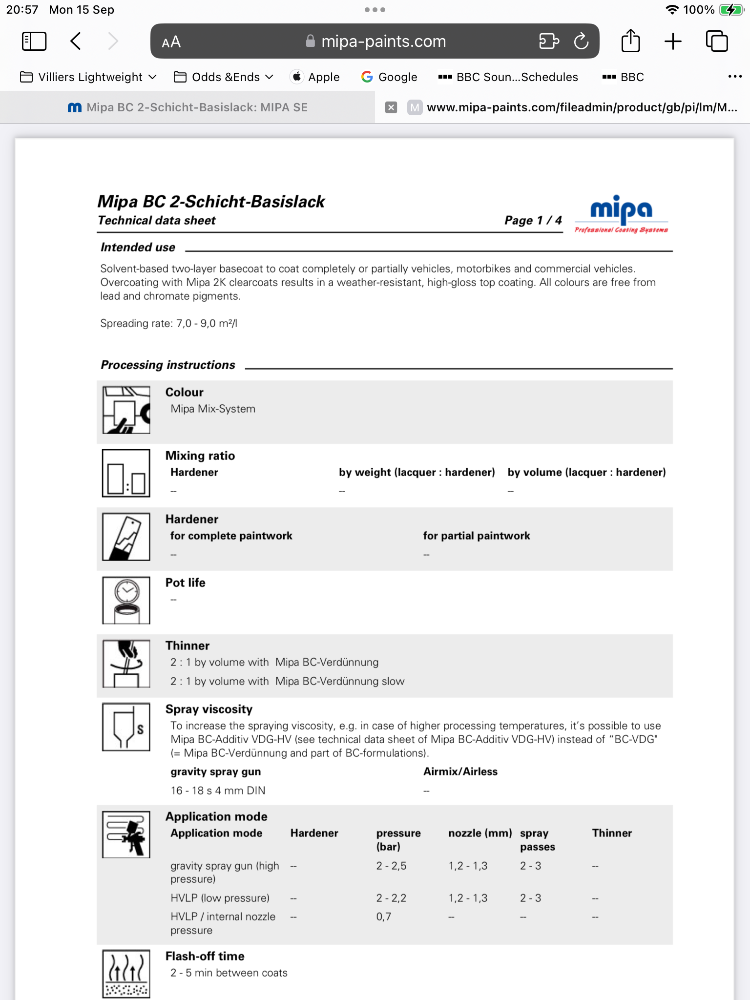

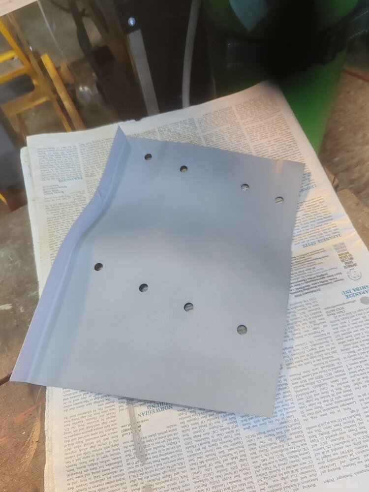

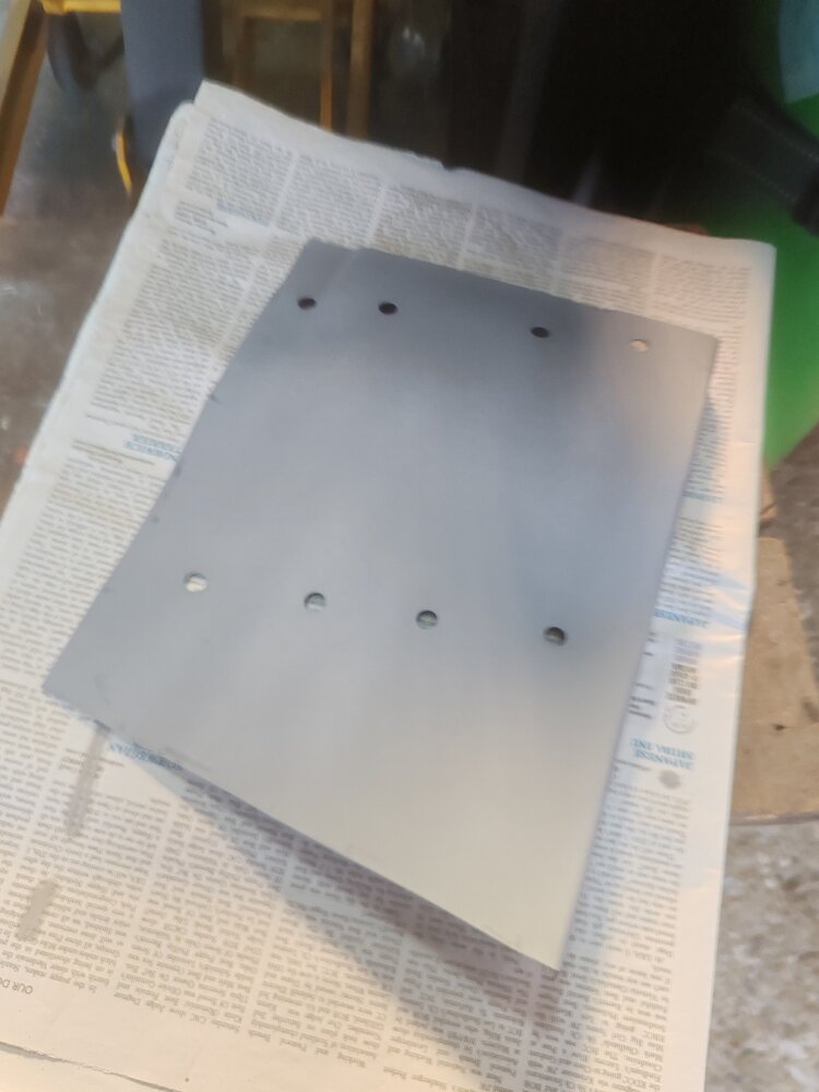

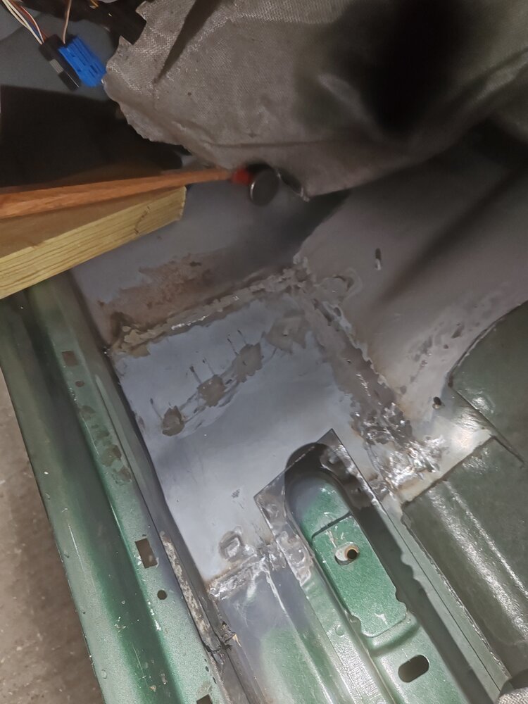

Dont eat the pie just yet, the MIPA data sheet does specify both ways either straight on with 3 coats of thinned colour and clear coat when dry and roughed up or 1 coat of colour with hardener, another coat just thinned and then clear coatLooks good, just off for my daily humble pie.
What pant did you use?
It may all peel of like a bit sheet of clingfilm yet so lets see how it lasts
