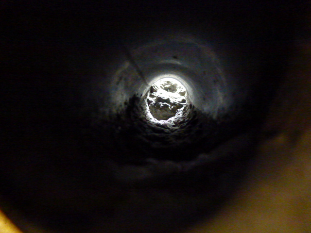

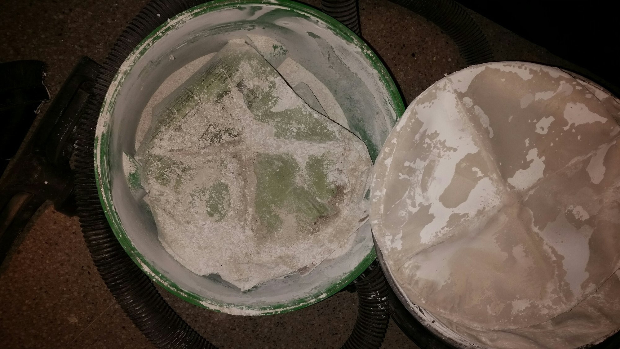

First thing I noticed was the hard lumps in the bag, which turned out to be cement! Further investigation found cement deposits at every joint in the hose & the tube elbow was blocked halfway across!
Obviously some lazy builder had been using it to tidy up after himself!

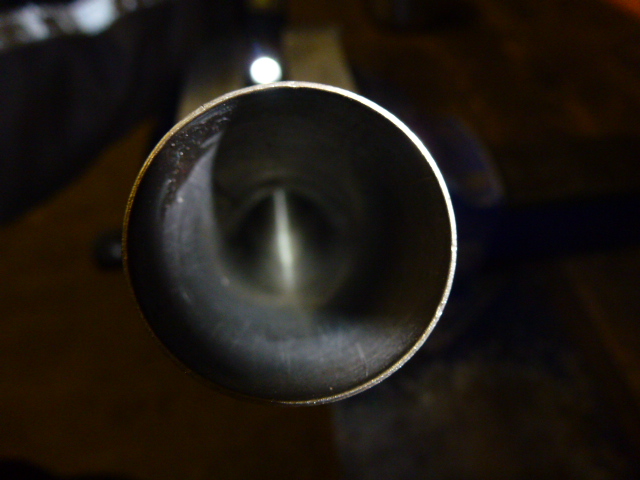

The hose was easy to clean but it was well stuck inside the tube. I ended up heating the tube with a blowlamp & gently tapping which moved most of it, a rotary wire brush got the rest.

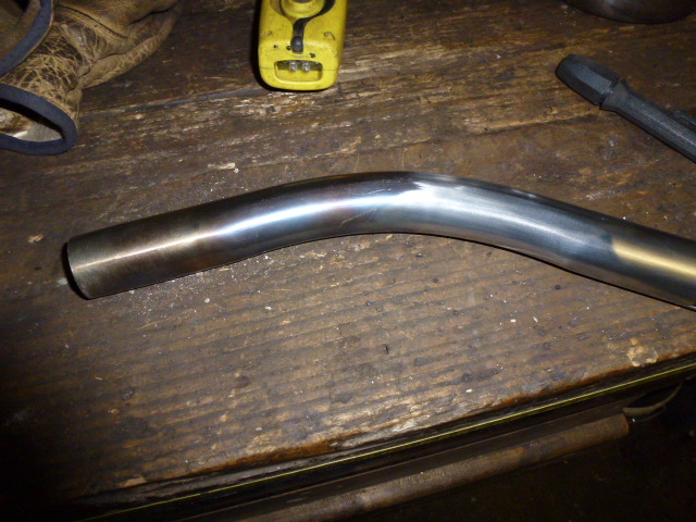

Clean & shiny inside, outside not so much.
Got busy with the metal polish & had it all shiny again.

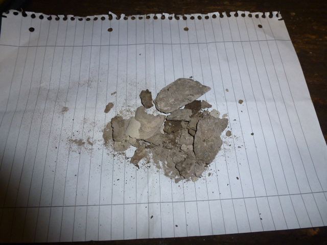

This is what came out, it's going in a bag & will be produced at the next church meeting!
So don't feed your Henry cement, it will give him constipation!
