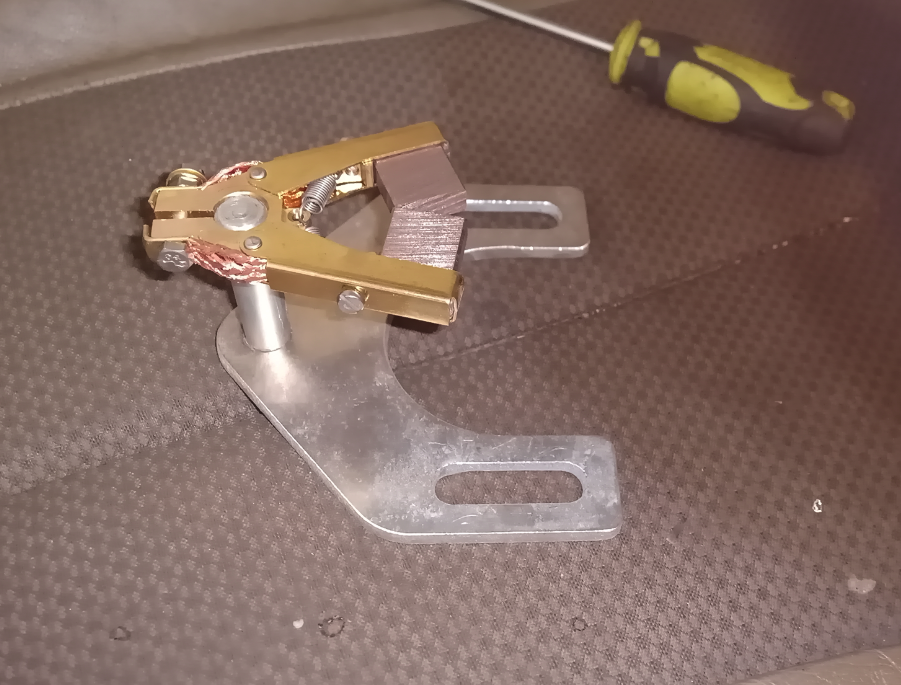

Seeing as I was was making a bracket for a shaft eliminator I thought I might as well video the cut.
As can be seen in the video I am approx 614 rpm, the aluminium is 16mm and being reduced to 14mm.
The shaft eliminator bracket.

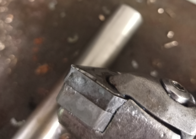

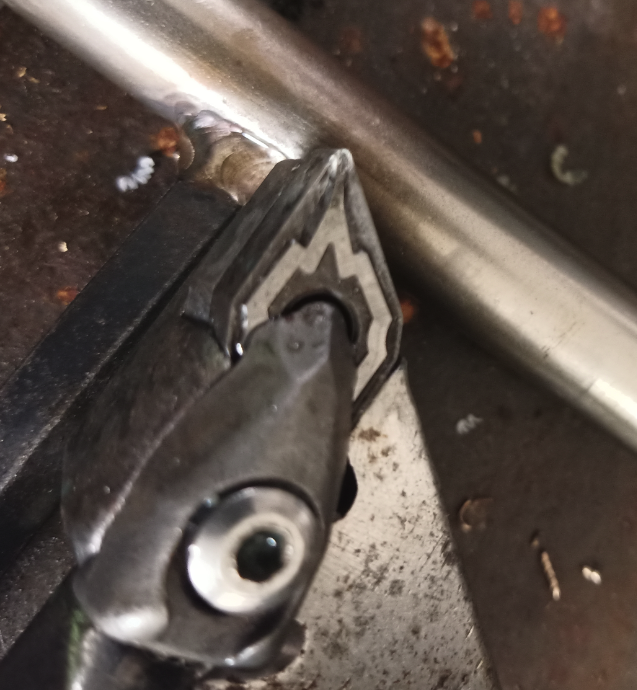

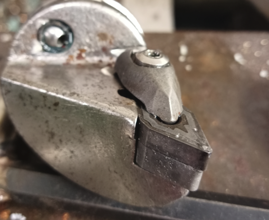

Pic of the insert showing it is nothing fancy and actually not the best for aluminium anyway, also it is really needing replaced.
