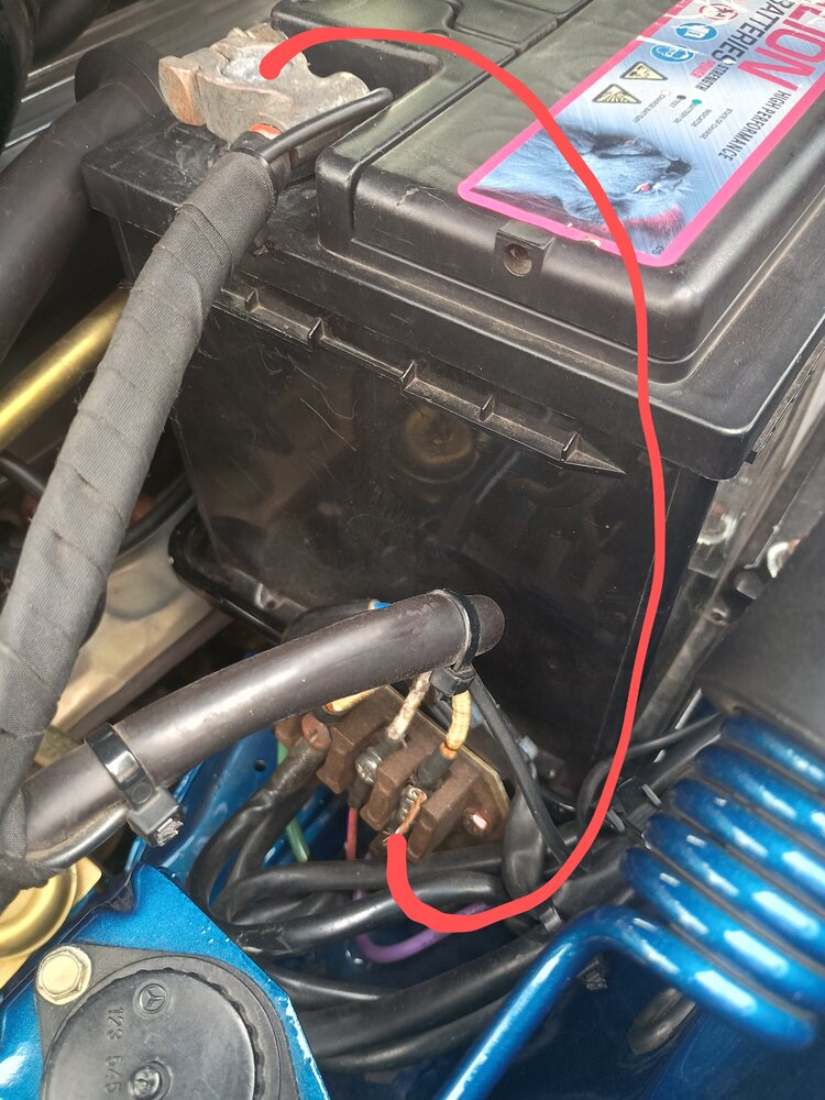

This happened yesterday for the first time, had been out for half an hour or so, a few stops and starts then after the final stop the car wouldn't start. When attempting to start the is a click and I can hear the fuel pump but the starter doesn't turn over.
I called the RAC but they said they would be 3 to 6 hours so went for a snack and on my return to the car checked the battery lead for tightness. It was a bit loose so tightened it up and hey presto the car started on the next crank.
However I think that was a red herring as the same has happened today. I think yesterday the starter/solenoid just had time to cool down.
So here I am 20 mins from home waiting for it to cool down again. No easy way to get to the starter motor here at the side of the road.
Once home I'll get it up on the ramp and see if it's the solenoid that's clicking and check out the connections down there.
