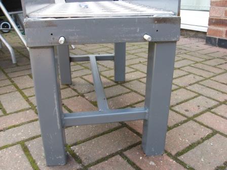

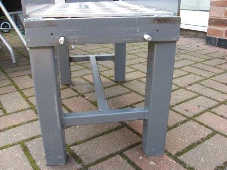

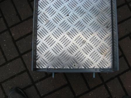

B Badgerdid Member Messages 10 Apr 28, 2009 #21 ramps Like these, normal ramps are too high for the front of my car. Can i ask how do you attach the ramps to the support section? any chance of a pic or simple diagram.
H hfturbo Member Messages 6 Apr 29, 2009 #22 re Does this help? This is the stand looking at the attachment face and from above... the ramp part has a angle face to mate up with this with location holes in, welded on at the ramp angle. The best part is they are really easy to drive up. stand.jpg 35.6 KB · Views: 1,631 stand2.jpg 41.8 KB · Views: 1,626
