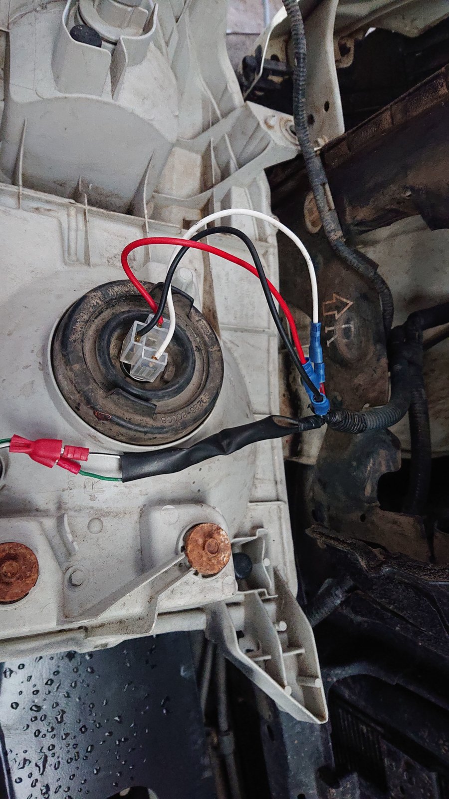

I’ve had problems with some Japanese car headlights that have a live feed to the common connection on the bulb with the other connections being earthed by the dip switch , sometimes via a change over relay. A bit of abode but possibly the easiest way of sorting the problem might be to just swap the wires on the bulb connector as already suggested?
Thats probably going to be the solution, I was hoping to find something where they had cut and swapped wires as with so many other things on this vehicle. Anyone know how the h4 bulb should be wired so I can redo it?
