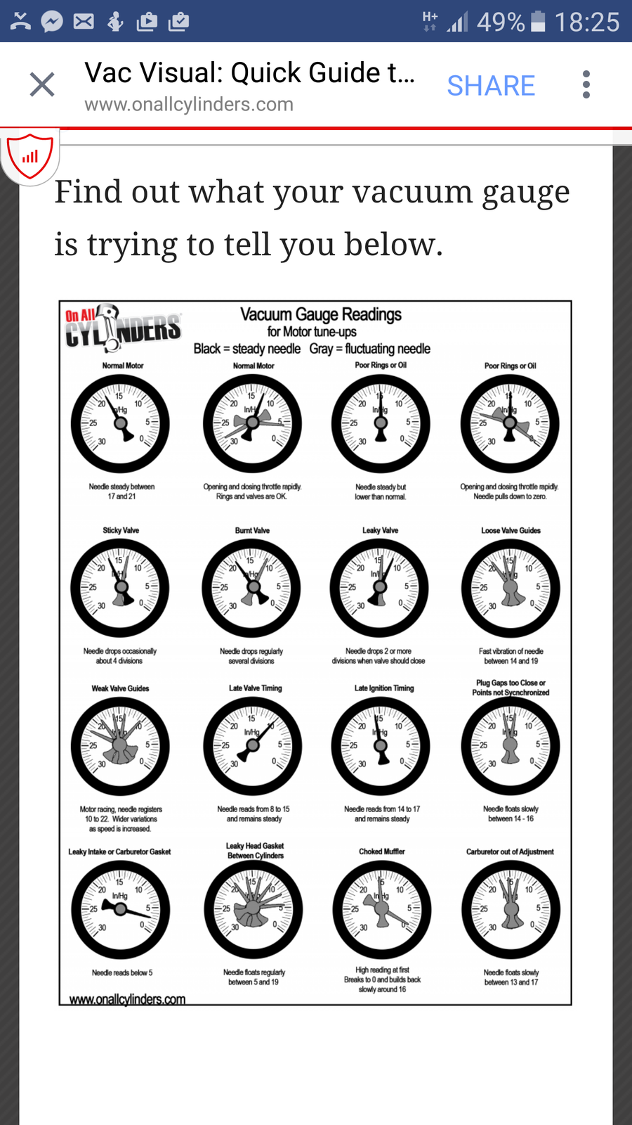

yeah good call does point toward it...ive had it all off several times now , nothing from spraying carb cleaner around the joints etcLeak in inlet manifold or throttle body gasket? Vacuum hose leak?
none of that ...vents to air , i mean a catch canCrankcase vent (regurgitation thing)
A compression test alone won't do that. A second compression test with 1/2 tsp of oil to seal the rings can tell of it is rings / bores or something else.
how so what would i look for ...might struggle though as im working aloneHi, Yes and watching how the pressure builds up will tell you if it's valves.

TBH watching can't tell you AFAIK. A burnt valve, a slightly leaking valve and a valve sealing under pressure behave differently. Oil will say it's not rings/ bore, all it then says is it's above that, you can even have a head gasket failure between cylinders.
If the valves were leaking enough to mater I would expect the compression to be well down.does the pop pop suggest to you valves ? ive never had a car with bad valves so im in the dark
the fair compression test results suggests to me rings are ok
