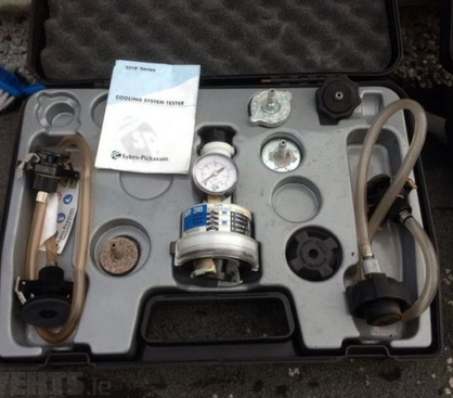

What does it do? Just pressurise the cooling system?I've got one of these, don't use it too often but when I do it saves a lot of messing about..
