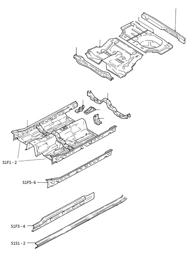

Have you priced up all the panels you need,are you going to get them? I would if meWell a decent day of searching has brought up this in terms of repair panels. Full floor, all 3 sills etc.

yes, the very same.Are they from Ex-Pressed Steel Panels?
This is a restoration to keep forever. After my last roll of wire off the bay of all evil I am never buying anything like that again. SG3 stuff welds so much smoother. And yes, panels come to £1200 ish, which is not too bad when I consider the time it will save making stuff up. My Bro said he wants it right, not rushed, not cheaply done, just as good as it can ever be.Whats the big
Have you priced up all the panels you need,are you going to get them? I would if me, if not,you're going to have source some sheet and fab them up

1.6 is a good start for your practice but that shell will be more like 1.0 than 1.6!yes, the very same.

And the replacement panels will be even thinner1.6 is a good start for your practice but that shell will be more like 1.0 than 1.6!
