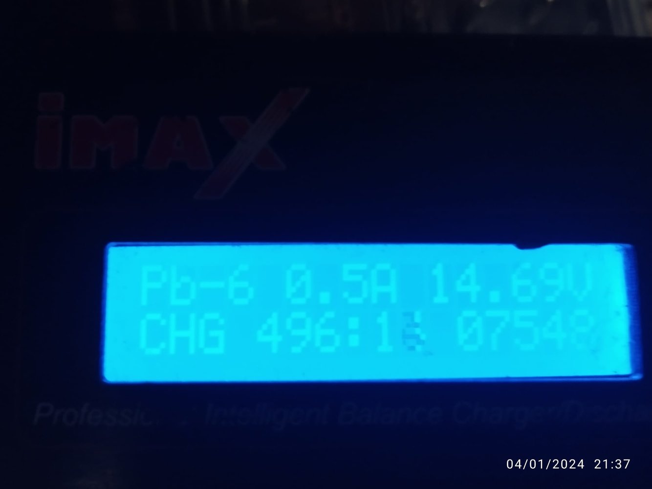

As it happens, I only found out yesterday that my Astra's battery went flat over the Christmas period. That battery is 5 years old - the second one on the car. The first one failed in exactly the same way at the same time of year at about 5 years old as well. I've had it on charge 24 hours but it started on 6A and was still on 4A this morning, so I reckon that one is gone as well. Started the car OK but no doubt will fail me pretty soon. So looks like buying two batteries now.
